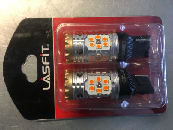

You are correct, you must be careful when purchasing replacement 7440 bulbs, some may not have that locking tab and will not work for our Camaros.
I recently purchased these from Amazon. You can barely see the locking tab on the bulb base, but it is there and it works. These bulbs have worked fine and no external resistors needed. Made in China. If these don't hold up, I will install DD bulbs and resistors.

I know the ones I used and got from Amazon have worked flawlessly. The passenger side install was cool but drivers side for whatever reason, the bulb fell inside the housing and was a bitch to get out but we did.
I ended up just taking some electrical tape once in socket, and going around the base of the bulb to be on the safe side.

Got them Saturday and installed them. No hyperflash at all and quite brighter than the stock flashers. From what I can tell these lights on the car never come on other than for turn signal use. Not sure why I thought the amber grille lights on our cars were parking lights as well as flashers?!?
