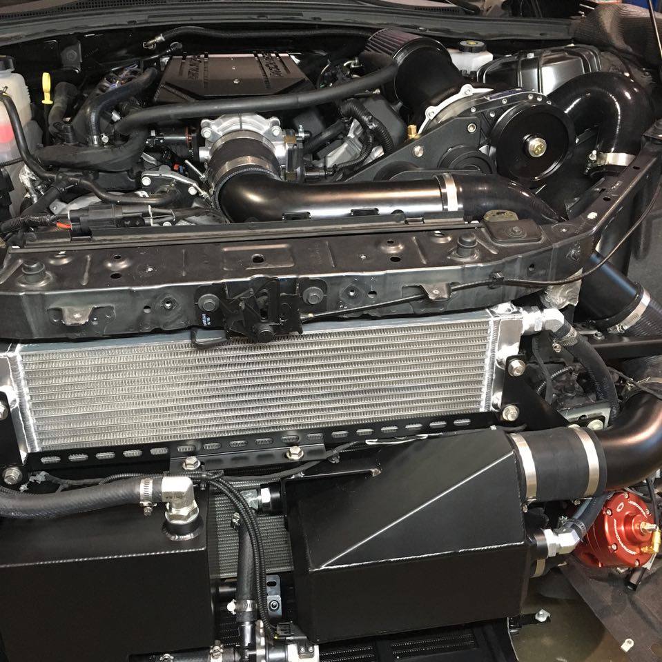

"The best we could do for the race intercooler would be 1190 shipped. It’s a very large intercooler which would require cutting and modifying parts behind the bumper. Unfortunately we would not be able to take the Stage II back in on trade or to reduce the cost."
And if you look at the Race IC picture, you'll wonder the same thing, because he did post "PRETTY EASY SWAP OUT". You think so?:

Joe.. I'm going to ass-u-me you have a general knowledge of how to work on cars. So I'll give you the cliff notes on "how easy it is"
1. remove front bumper cover
2. remove stage II intercooler
3. removed front crash bar
4. removed drivers side aux radiator
5. install new BIGGER RACE A2A intercooler and piping
I'm also going to ass-u-me that because this is a RACE part Procharger can't advise you on what needs to be done for liability reasons..

And cut off part of the front facia, and forget about the crash bar. That is not an easy swap out, Perdieu. That is a mayor car mod.
I know you are a SUPER FAN fan of Procharger, and their rep here, but you can certainly ass-u-me that their stage II I.C. is not large and/or good enough for high elevation, high temperatures (100°F), dry weather (15% humidity) conditions.
4 bolts to take it off = major ???? (yes mine is off see picture)
