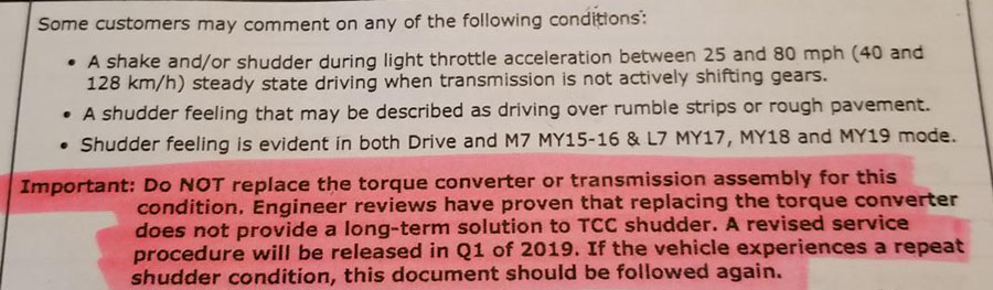

Originally Posted by Klayman View Post
This says shudder is seen in Drive mode or when manually set to gear 7 for 2015-2016 Camaros.
But what does the phase "& L7 MY17, MY18, and MY19 mode." mean?
I have a 2018 so I am wondering the meaning of this is for 2018 models.
I ask because I took my 2018 back to the dealer for shudder and they checked the codes
and test drove it then told me the car is functioning as it should and that shudder is
impossible for the 2018 models.
Thanks
T32803 is offline   Reply With Quote

I am still hoping someone can translate the above service bulletin's
verbiage for 2018 model year Camaros.
Thanks
I believe that means shudder in seen in drive mode or manual mode in 7th gear for Model year 2017, 2018 and 2019.
Find a more decent dealership. They'll verify the shudder and do a flush with a new 2019 fluid and trans flush tool based on the latest revision of the TSB.
As to the longevity of the new flush, most have doubts and it's only been a few weeks, but AFAIK nobody has posted a shudder report after it so far.
