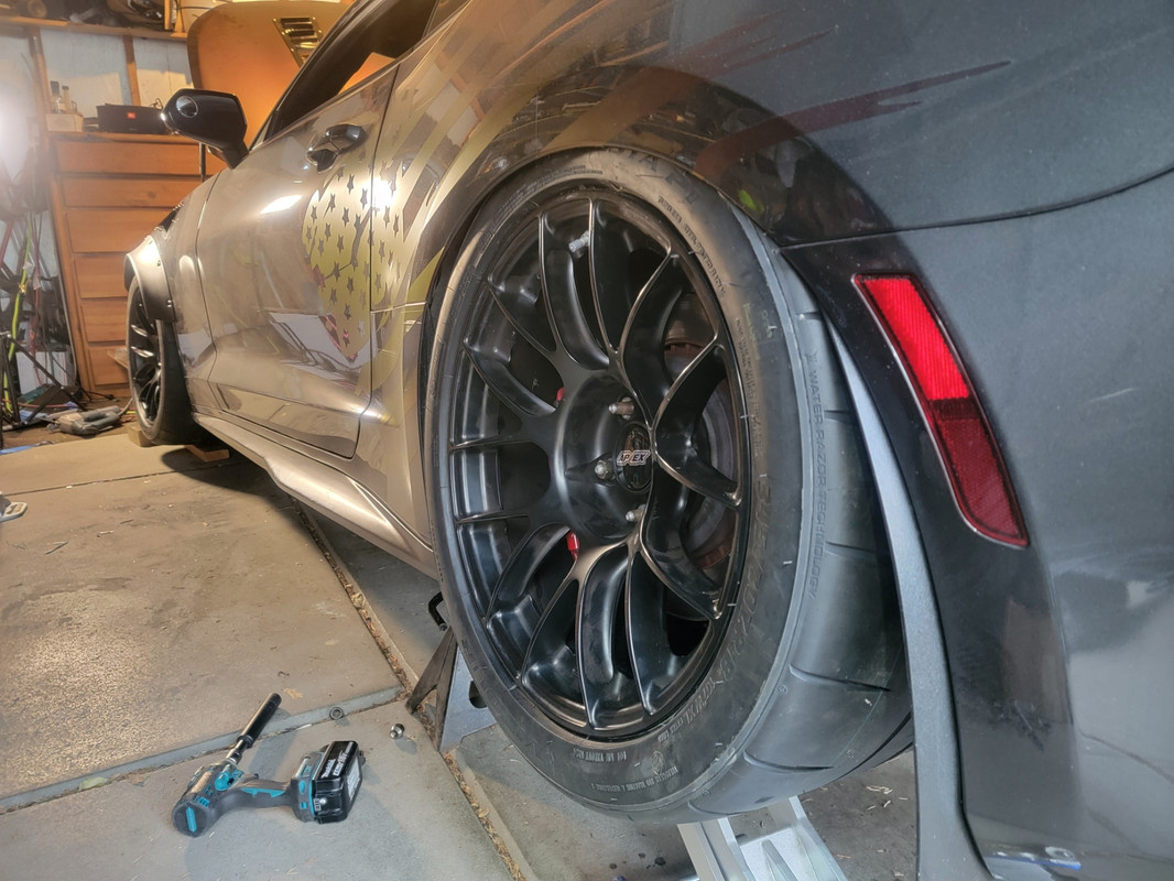

So far I replaced the front tension/radius arms as the bushings were toast, just got some ZLE arms. I looked at SPL and I think they're inferior to OEM while costing a lot more.
I did an alignment and created more space in between the tire and spring perches. I spend a little bit of cash on a home alignment setup and it's awesome. Took a few minutes to get setup right but once you get the hang of it it's pretty simple.
I installed Race Louvers fender vents. This was a larger PITA that I thought. Supposed to be for the Camaro but it's flat and the fender is not. Race Louvers seems like a decent product, but pricey for what it is. I cut some holes in the fender liners and covered the holes with screen material.
I installed flares on the front fenders, it turned out decent. I'm going to make a flat flare that attaches to the same points as the flare so I can run narrower wheel/tire setups without it looking ridiculous.
The rear barely fits. I need to adjust the point where the rear bumper cover meets the steel fender, there's a sharp fold there that is the only thing that could be a real issue. It looks like the tire is touching the fender in the pics, it is but just barely... so barely there's no friction. I think I can get away with running the rear fenders as-is and just adjusting that one little sharp part.

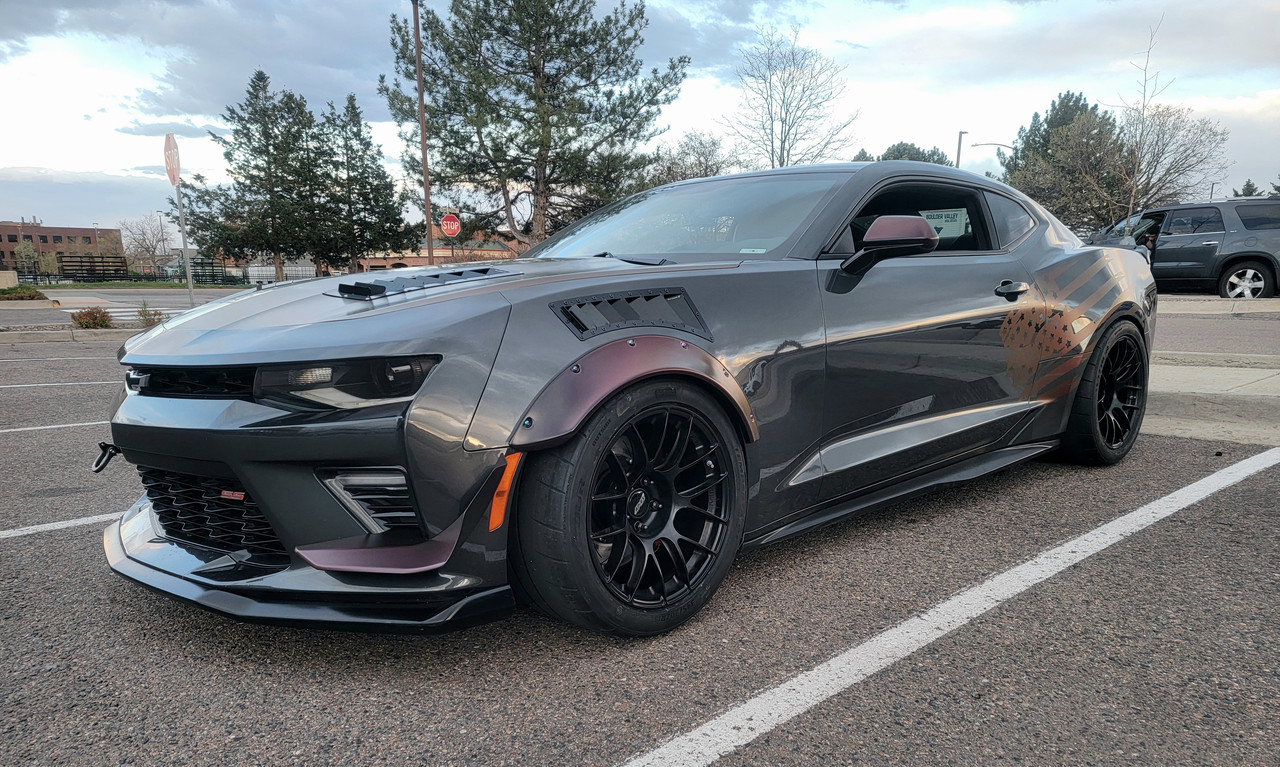

I finally got the car ready... changed fluids, installed new front rotor rings, vinyled the flares and put the 345 P1s on, wheels are Apex 18x12 et41. Fronts use MSI Mustang wheel studs and 38mm spacers. The car is a little lower than stock, I honestly have no idea how much, lol.
Eventually I plan on having 3 sets of flares, a flat flare for OEM 10" wheels, and a flare that's otherwise the same as the pic but sticks out about 1" less, those would work well for 11" wide wheels or running a stretched 12" fitment.
Car drives well, steering feels responsive and accurate so far, a bit softer than the REs, but I was running 295/35 on the same 12" rims, which was pretty stretched but worked really well, I might get another set as I got a smoking deal on another set of 18x12s I couldn't refuse. I theorize the REs will be better for events where the tires won't be as hot, or if it's moist REs are clearly superior according to GRM tests. It would also be interesting to see if I can compare them at HPR or an autox. I couldn't corner anywhere near the limit but I can say the P1s put power down pretty well.

Wow, really nice job!

looks awesome!
