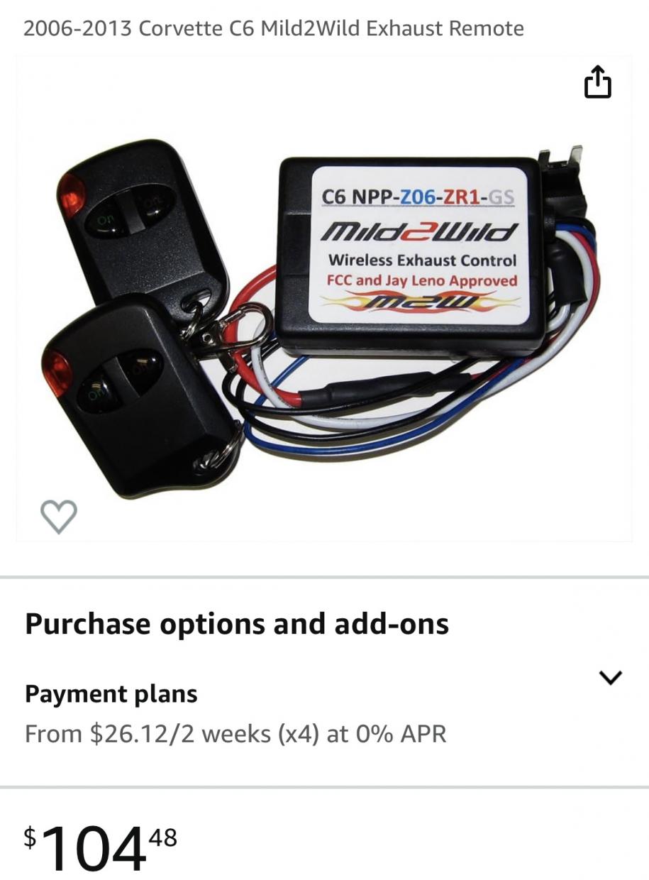

I recently purchased this plug-and play remote switch and am going to substitute for a fuel system fuse as a critical system cut off. As soon as I can confirm it works 100%. I will give the heads up.
That’s a great idea…

I have already confirmed it will handle a 20 amps
If it works, I may have to do it too.
