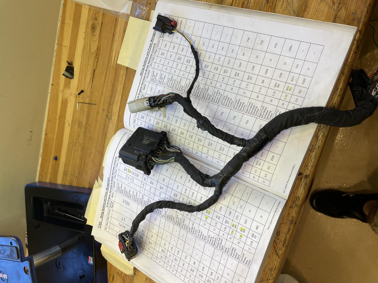

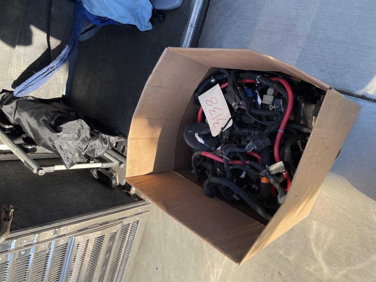

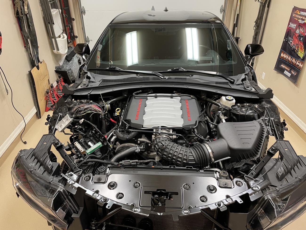

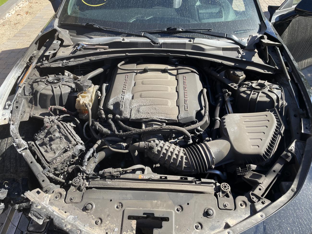

Chassis wiring harness. It’s probably the biggest reason they totaled the fire damaged salvage Camaro SS I bought. No way was I going to replace that harness. Unlike your situation I had nothing but a bundle of burned wires, some the same color and gauge that had to be traced and sorted out. It was a test where anything less than 100% was unacceptable. I staggered my splices and used solder and heat shrink tubing, will probably outlast the car and can’t even tell with the factory wrap.
I used a ZL1 harness and changed a few pins. The harness for my car was not available from GM.
I can’t imagine that a heat burn from header contact would damage the harness inside of the firewall.
I also changed the engine wiring harness (pictured) it was a pain but could be done without disassembling the entire car.

Old 12-02-2022, 08:20 PM   #54
Z OH 6
Drives: 2024 CT5-V Blackwing
Join Date: Sep 2020
Location: GA
Posts: 3,557
Man, that looks like it was quite a job. I bet that took some time.
