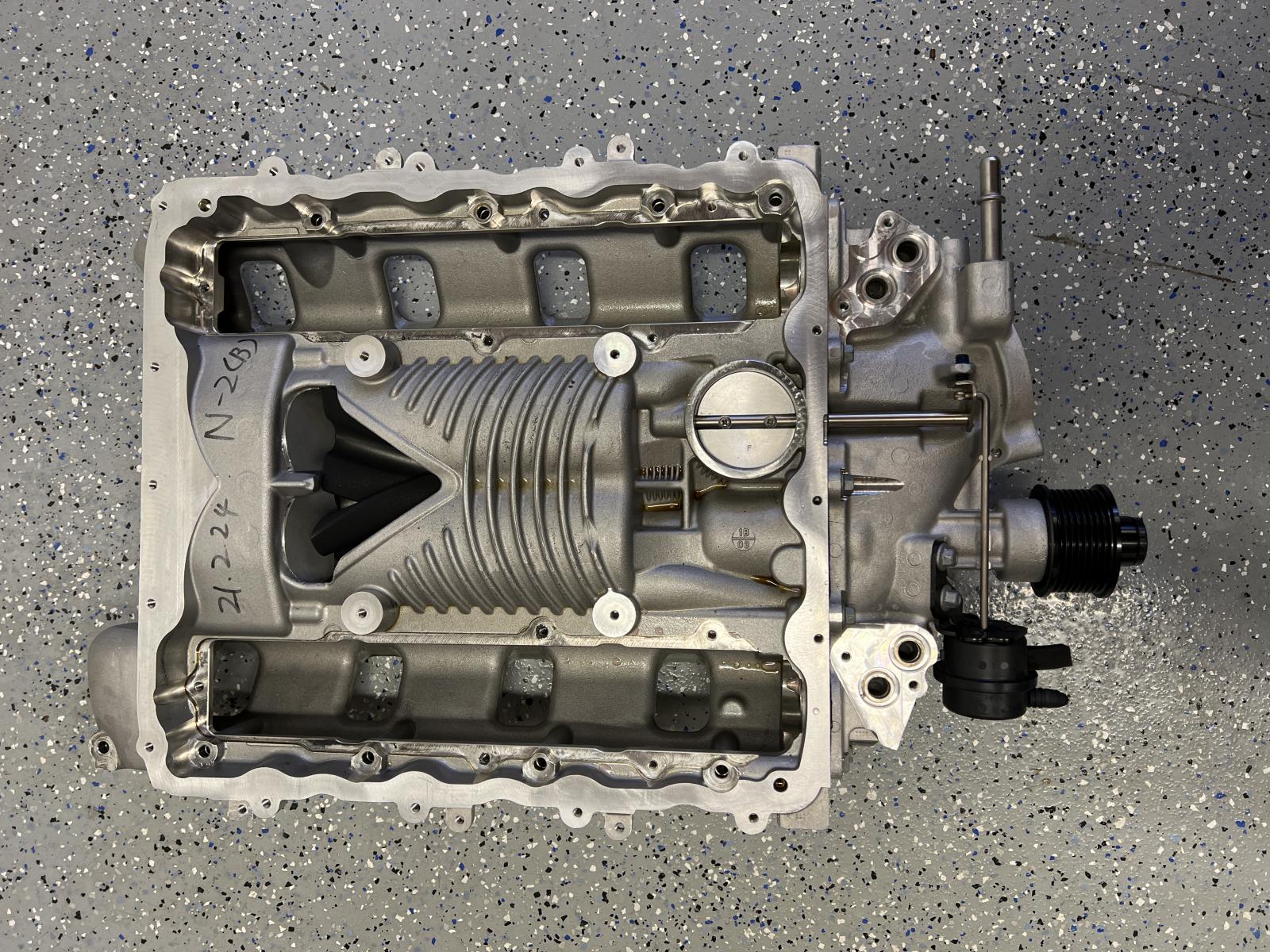

Not much progress this week... Sent the blower out to Katech for some porting...
Received my TSP DoD Delete Valley Cover... Still debating if im going to port the heads myself... stay tuned

Hey guys... quick update... Just received some photos from Mike @ Katech of the blower work they are doing... they should also be receiving my heads today for some tender love and care
Stay tuned for more!

Yeah... trust me i have everything to do it myself, except the time. I was also worried about getting the runners to match. Found a local flow bench for $200 to flow both heads, but then would have also needed to purchase a stock sized set of valves to clean up the CC, and a 90% smaller valve to open the throats... once done, figured the cost would have been the same, and would be silly to think i could do as good as the CNC file... i'll still end up cleaning them up a little when i get them back just to make myself feel better
Also going to port match the blower to the instake runner... as Katech does not offer that. Stay tuned : )

Well... I am happy to announce that i received my heads back from Katech yesterday, and will be receiving the ported blower back tomorrow... As you can imagine, they look pretty nice and I even did a quick test fit of the new cast valve covers... Here are a couple photos... alot more to follow as I jump back in the project this weekend. Hoping to do the following this weekend.
1. Assemble the heads
2. Install new JRE cam + C5R Chain and LME chain guide.
3. Install and torque heads
4. Install TSP VVT delete front cover & Oil Pan
I guess I might even be able to drop the motor back in if i dont waste too much time stopping to take photos
Stay tuned!
