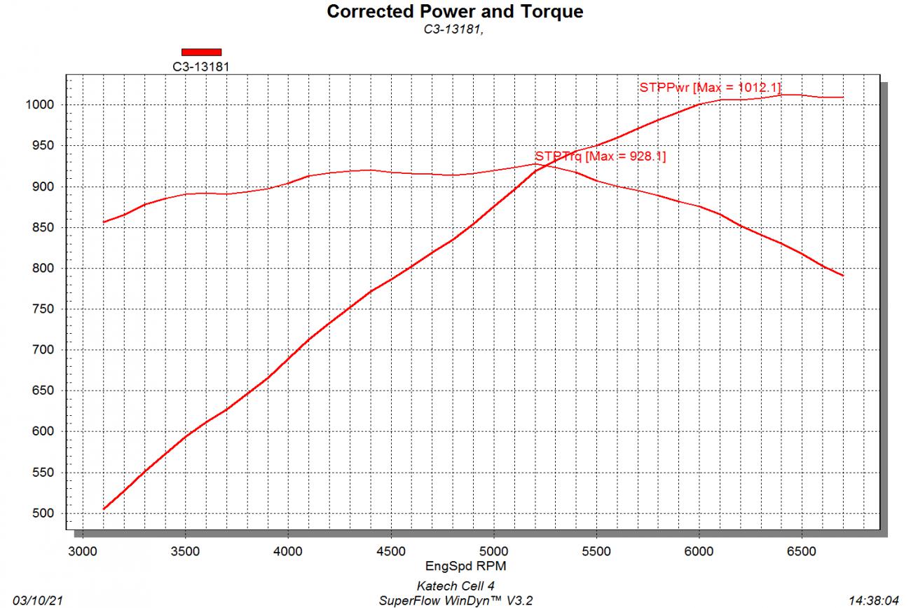

Katech just finished an engine for me. It made 1,012 hp on their engine dyno using 93 only. This is stock 376 displacement at about 20 psi of boost. (They use std correction.)
Name:  80mm Upper, 15% lower.jpg
I'll be installing it in a few weeks. Since it will be used on the road course though, I'll likely be stepping down the boost a lot.
Attachment 1061579
Which blower? And that number is going to be lower to the wheels, nonetheless, it should be around 900whp.

Posts: 1,567
Which blower?
Magnuson 2650

Originally Posted by travislambert View Post
Magnuson 2650
Not that you need 1200 RWHP but why wouldn't you get the XDI fuel setup Katech offers?
If there was a certain hp number your wanting to road course with would it make sense to slow the blower down and run full e85 to make up the hp with the timing you could run now? Not to mention since the car is all ready apart it maybe something to do so your not paying double labor for R & R the blower again?
The engine was built with the XDI injectors. I just didn't get the pump because it's $4,800 and I don't need it. It's not running out of fuel.
My goal was to have a more efficient engine that I could dial in the power as needed by changing pullies and a tune. As for fuel, I like 93 because they don't offer E85 at the tracks I frequent. On a road course, it's not uncommon to go though 40+ gallons on a busy day. 93 just makes sense. If I were drag racing, E85 would absolutely be the way to go. At a road course, not so much.
My car isn't apart at the moment. This was an entirely new engine, blower and all... not a rebuild. If the blower needs to be removed in the future, that's not a big deal. I installed the 2650 on my current engine, and it was relatively easy.
