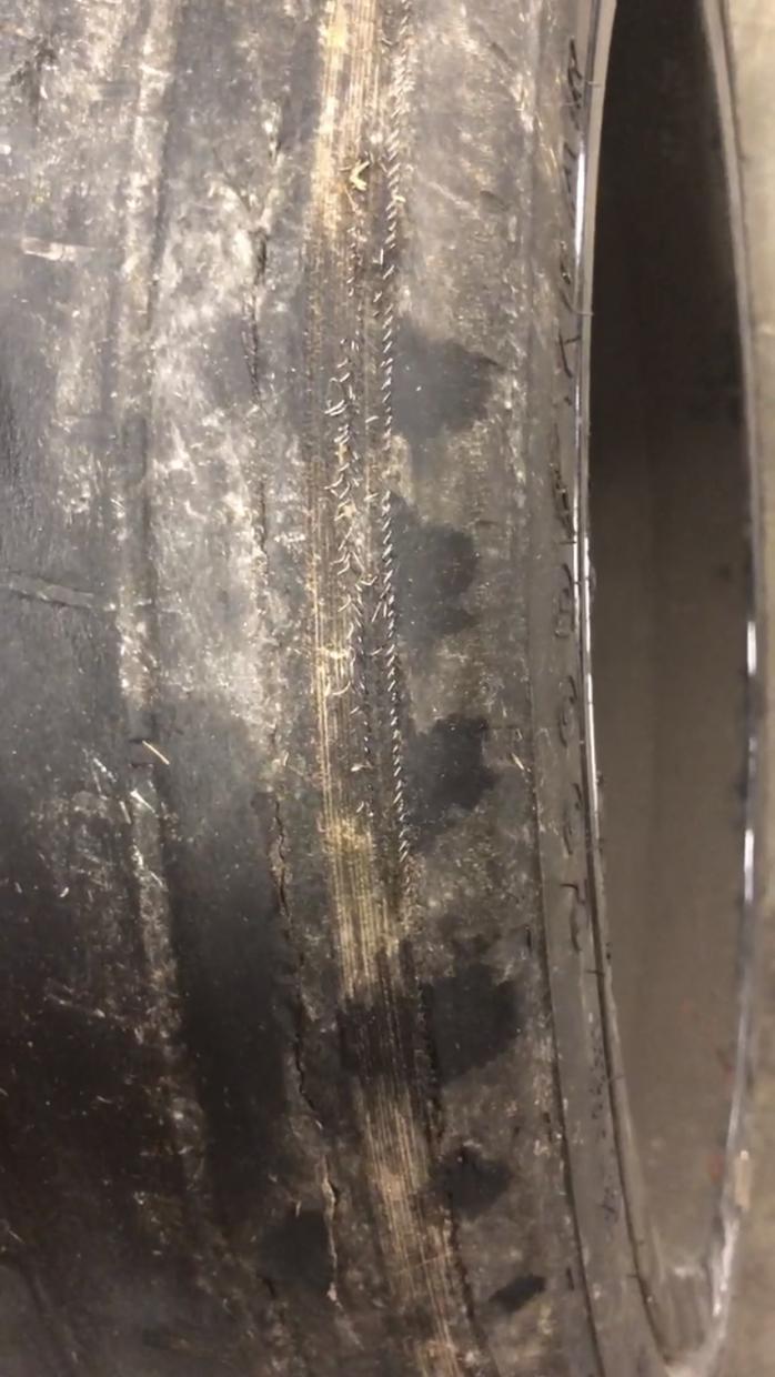

Front left after 2.5ish track days (this tires was on the passenger side rear for 1 track day after the dealership put a 285 on an 11" wheel and a 305 on a 10" wheel)

Originally Posted by GunMetalGrey View Post
Attachment 1041496
Alright, so we're in the same (tire expensive) ballpark. Just got another alignment today and was not far off from track spec, even after hitting a few curbs at MSRH. So the wear looks to be normal and not from knocking the alignment in to high toe out.
