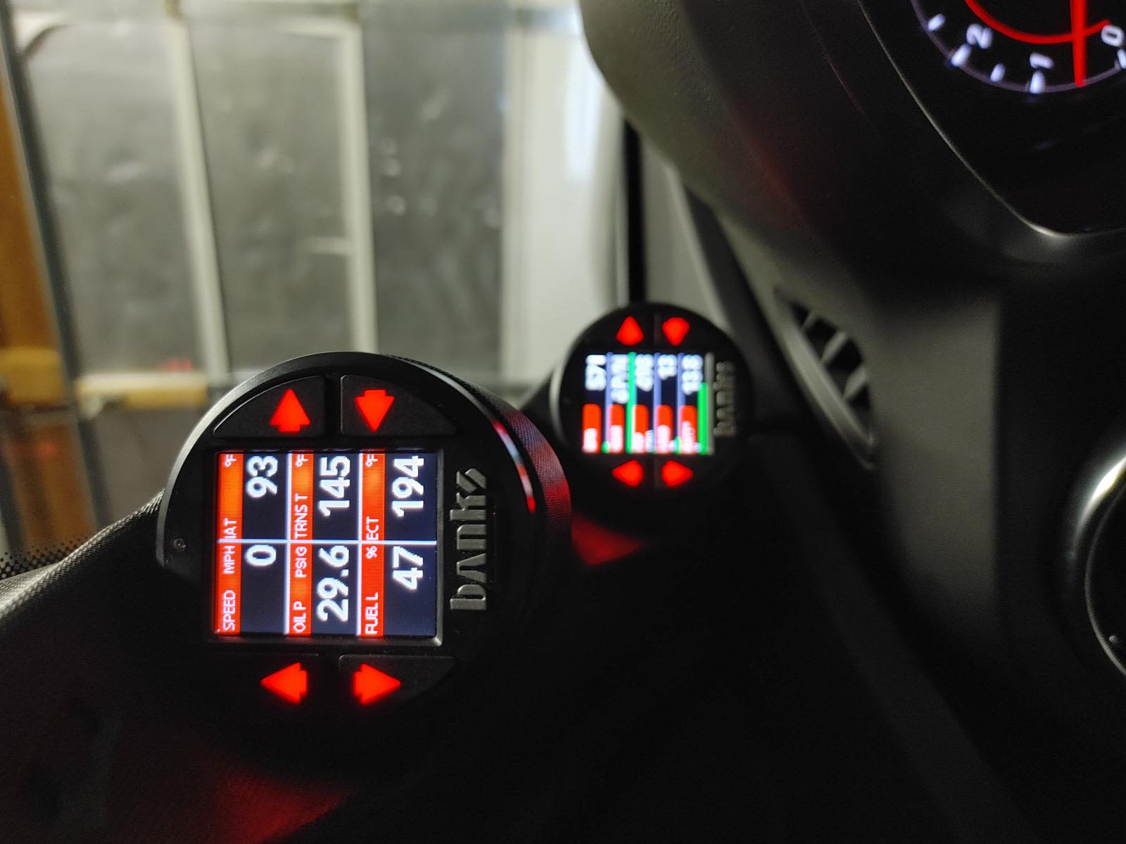

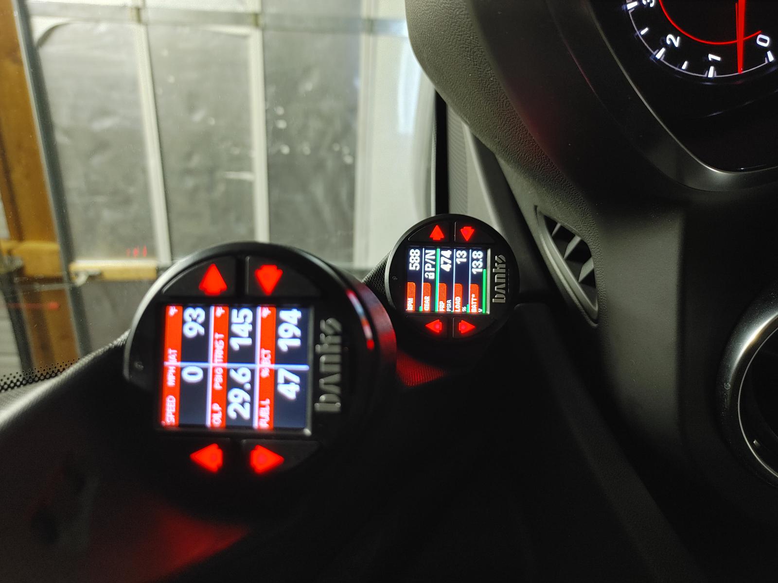

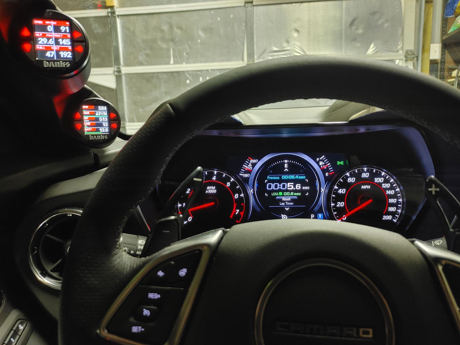

Thanks G2K for all of the feedback. I’m using windshield mount for now to supplement until I sort out vent gauge pod.

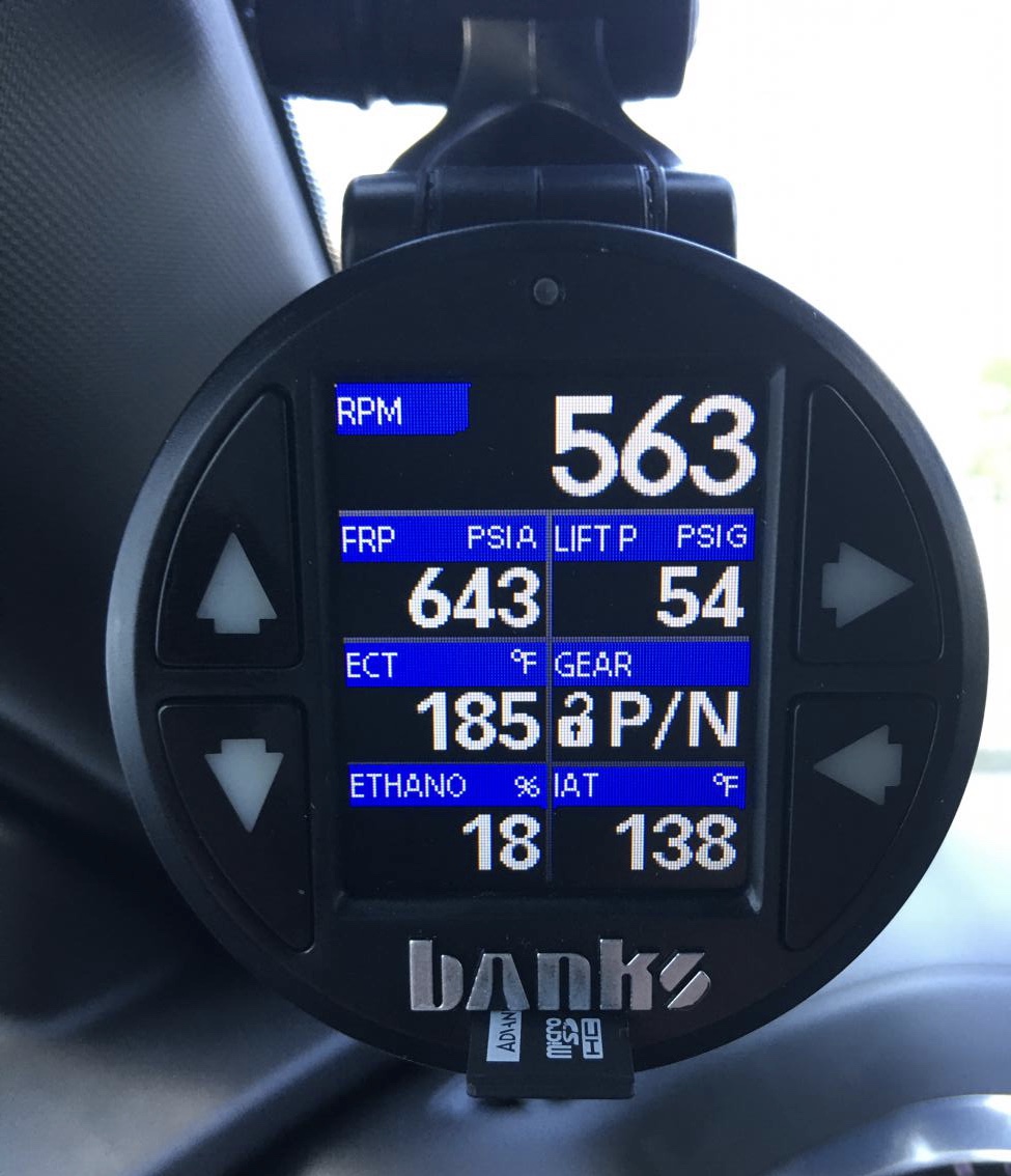

Originally Posted by G2K View Post
Yup, just got the update today and E% is now available. They sent me the test firmware before they make it available to general public.
Look at the bottom left PiD (green screen)
Other stuff that I now see activated (which weren't visible before are):
Gear selection
output shaft speed
auto-dimming
density altitude (is one of the patented PiD's from Banks)
Can you send me this firmware version? I can not find the ethanol option on my new banks gauge.

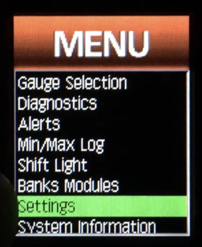

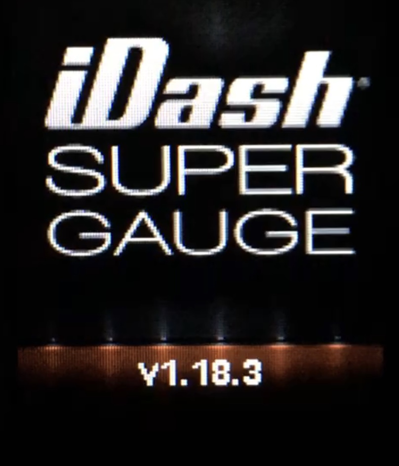

Hey man, you gotta select GM standard for vehicle. v1.18.3 is firmware. Go to fuel and you should see the ethanol option. Hope this helps.
