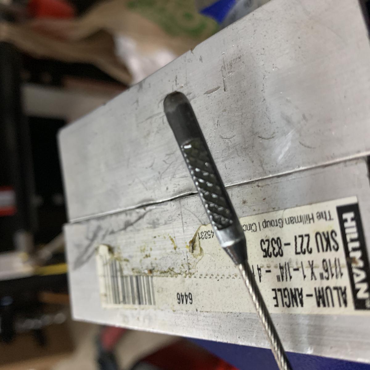

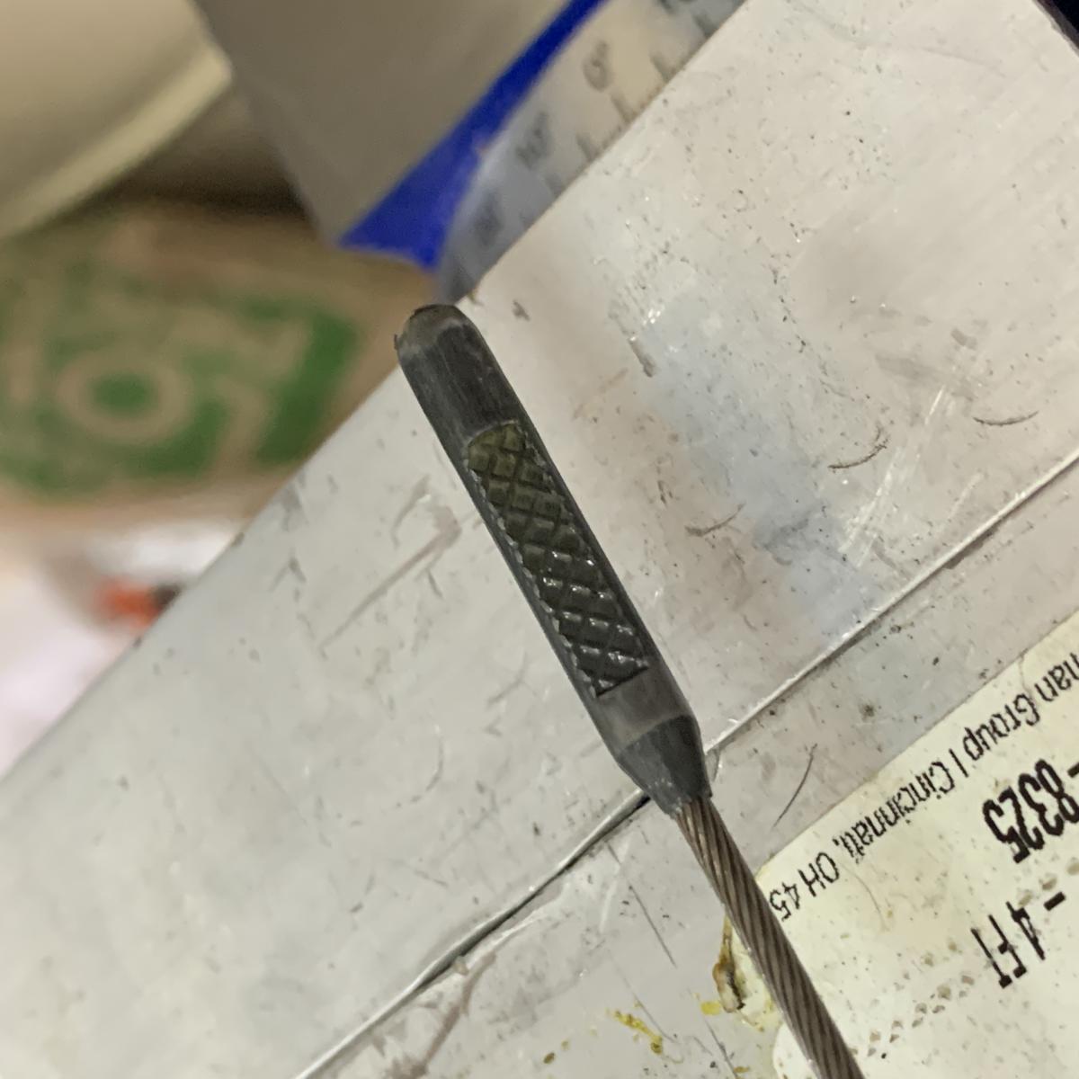

I rebuilt my engine over the winter to put in forged internals - 100% bone dry engine when I began assembly.
I used 1qt of oil during assembly, and before dropping the engine in the car, I prelubed the oil system thru the oil plug on the side of the block, filling it with exactly 2 more quarts in the process. Once in the car, I poured in 6 more quarts and measured on the dipstick, with just a fair hint of oil on the very tip of the stick.
I poured in the 10th quart, and it went exactly half way up the hash marks BEFORE I started the engine.
First pic is before starting (all components should be full of oil except for the feed tube from the bottom of the pan to the oil pump - half way up the hash marks)
Second pic is after the engine ran up to temp for 5 minutes, then was shut off and cooled for 2 hours. Once settled, the level was only about 1/3rd the way up the hash marks, with exactly 10quarts of fluid in it.
If your level is higher, you are over filling the engine.

Both of those images represent sufficient amount of oil. I personally would't add another drop.

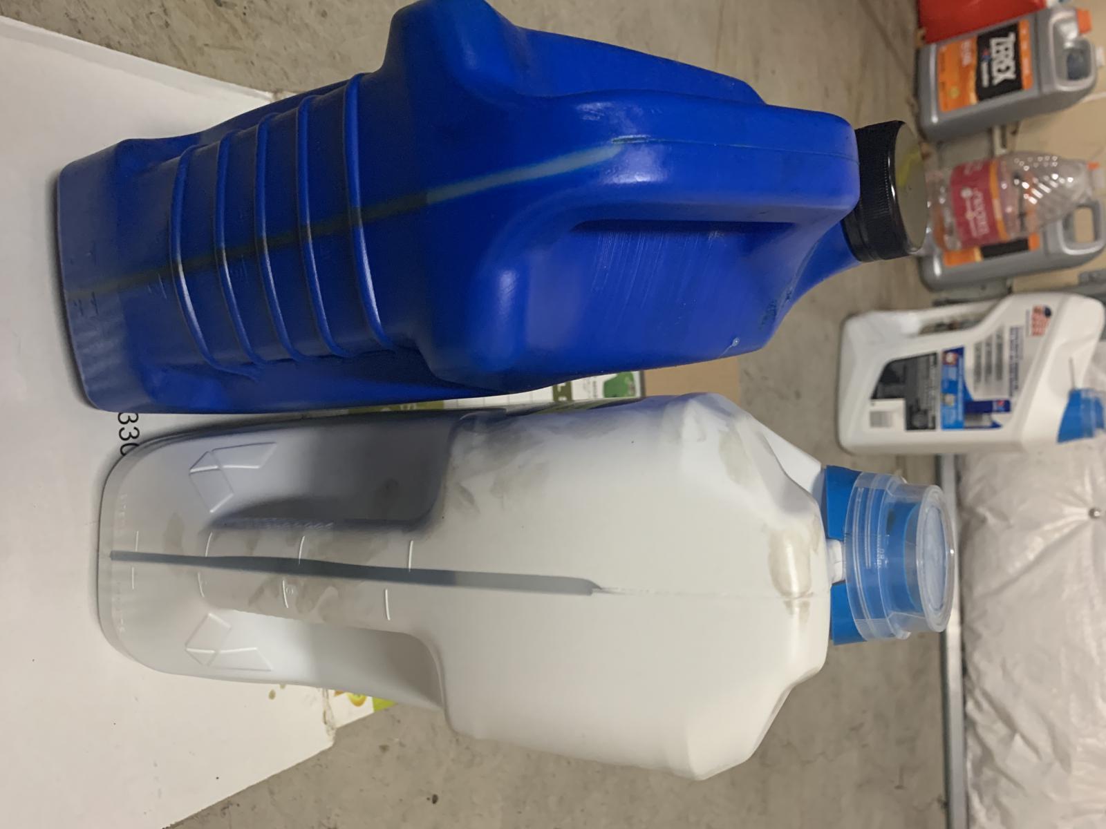

As a point of reference, I drove my car 150 miles today to break in the bearings & rings after the rebuild, so I wanted to change the oil to get the assembly lube / break in oil out.
Drained the pan for a hour (went in and ate dinner. Spun off the filter, spun on a new one, then put the plug back in.
I then cut open the filter to check for contaminates and let the oil drain into the pan with the oil that came out of the engine, which was an additional 1/2qt
So even with the oil out of the filter, which you will not get unless you cut it open, I only ended up with a little over 9qts that came out.
I put 9qts new in, fired it up, and it fell right back to 1/3rd the way up the hash marks - maintaining the 10qt capacity of the system
Picture is of two jugs, 4.5qts in each that I poured out of my drain pan.
