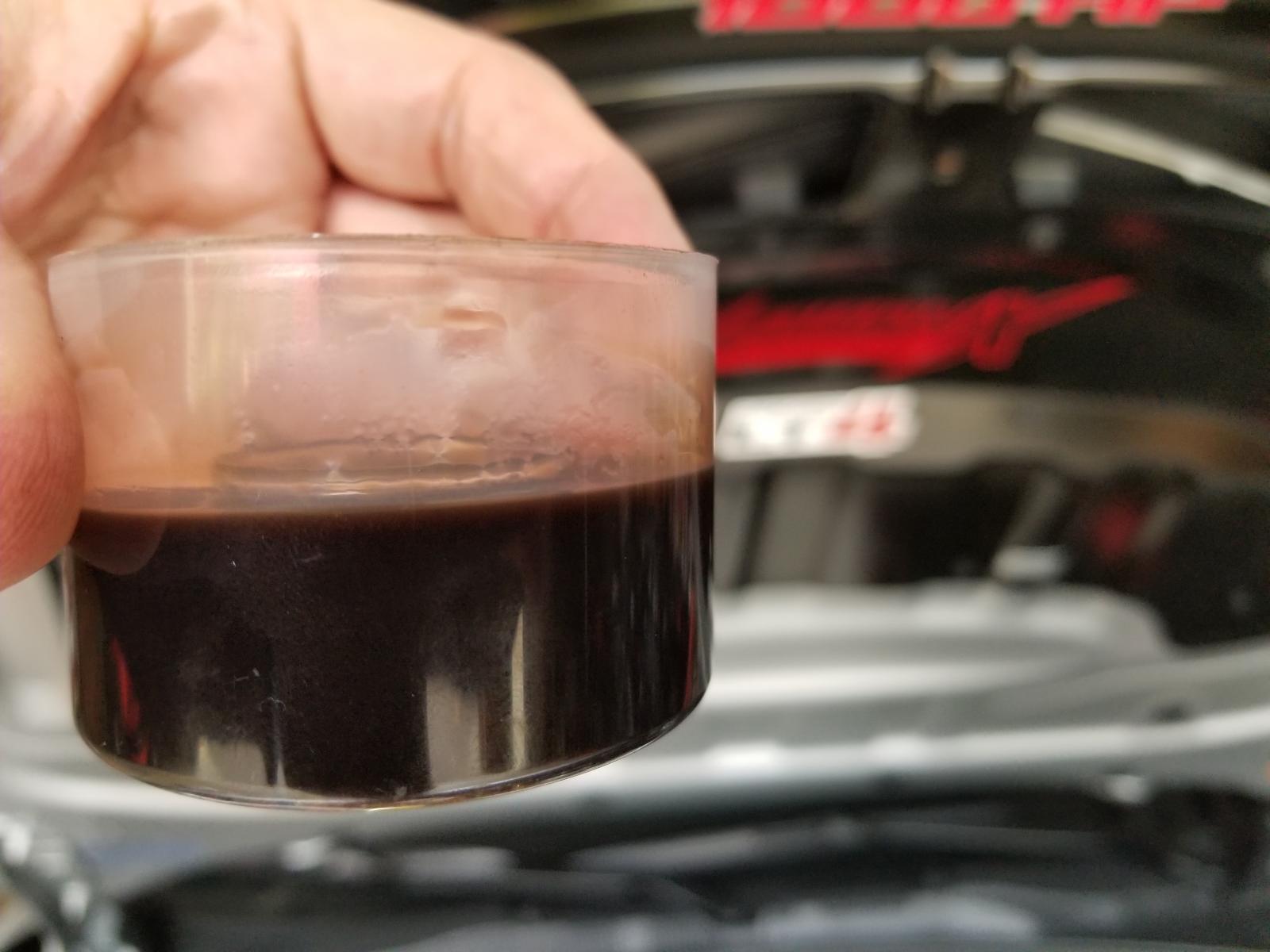

I check my Catch Can every 3K miles...this is normal.

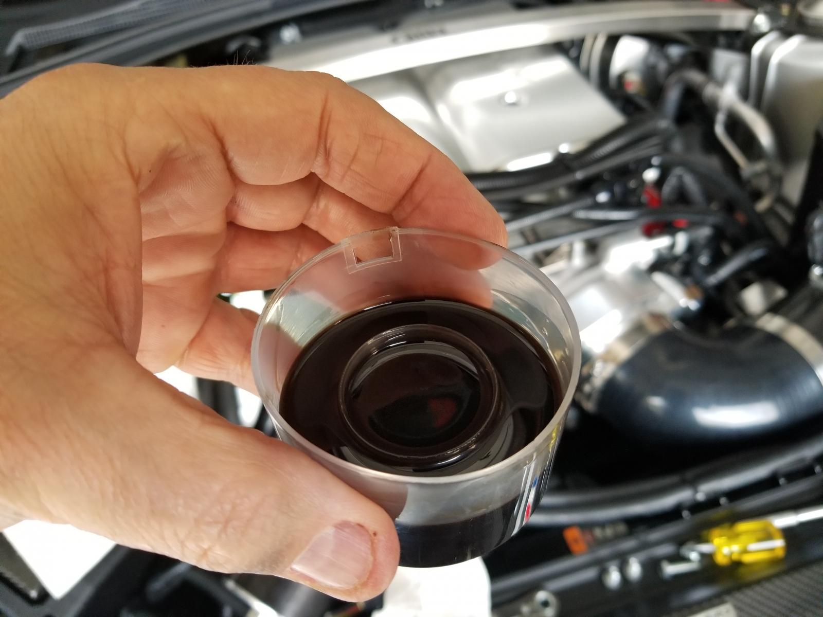

Me too. I get the same amount.

Pretty much confirms what everyone has been saying are the facts here:
  1. LT4 engines make blow-by. Lots of blow-by. Modified engines are highly likely to make even more.
  2. Catch cans will catch significant amounts of the blow-by.
  3. Chevy designed the LT4 so the blow-by doesn't make the horrendous build up on the valves and heads like some early 201x GDI engines did.
  4. Catch catch can vendors don't want to admit #3, and like to show pictures from early 201x GDI engines in their marcom instead.

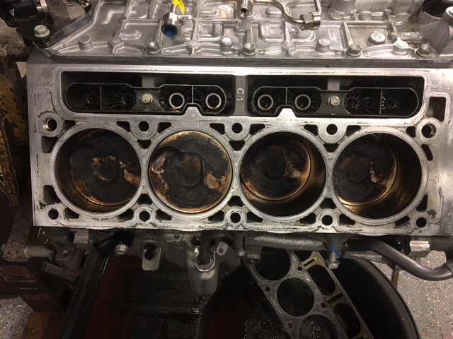

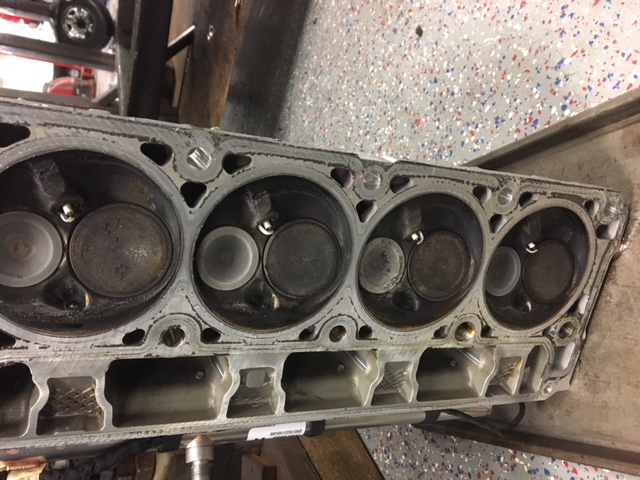

Here are some internal engine photos of my '17. This is at less then 6,000 miles and the car was burning a quart of oil every 500-650 miles. Engine replaced with a new one. E2X catch can installed with replacement engine - and pulls 2-3 oz every 1,000 miles.

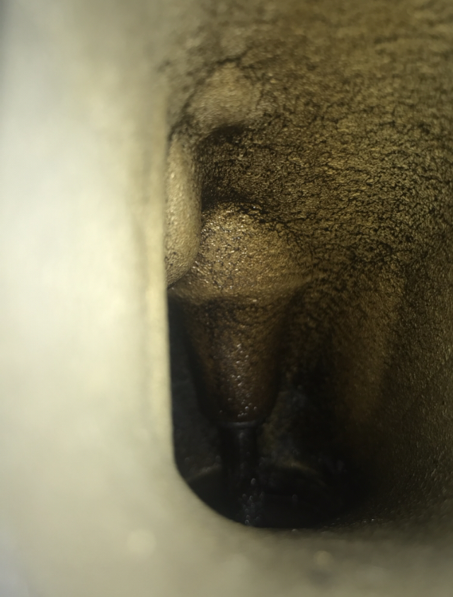

[QUOTE=Alain;10423905]Give it time. Two reasons why I think we haven’t seen many pictures of build up.
1- the LT4 hasn’t been in the Camaro for very long. I’d be curious to see if on the corvette world There has been more documentation since they have had the LT4 for longer.
2- you have to do some seriious dissasembly to be able to get to the valves and take some pics. That’s not something most people are going to do often. So hard to take pictures.
It’s not super significant, but more than I wanted to see after 11k miles. I installed a catch can during reassembly after seeing this.

That's unfortunate but it sounds like your engine was defective or otherwise damaged?
The pictures are showing the combustion chamber, not the intact tract/tops of the valves. The combustion chamber (especially in a car burning as much oil as yours) is expected to look fairly carboned up. The intake and valve tops/stems are what most are concerned with in a GDI engine without port injection fuel-washing effect.
