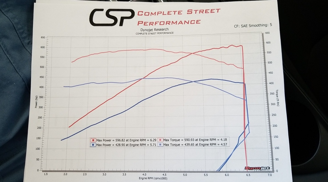

Got my car back on 06/29/18 from the tuners (CSP in West Chester PA). Hot n humid day, around 88 deg and 45% humidity outside. Car made 597 hp & 591 tq. Stock after a baseline tune in April on the same dyno was 429/440, so that gave me a 168/157 gain over stock after they tuned it. Bone stock all factory initial pulls were like 416/427 so gains over bone stock would be 181/164!
They told me the cats we getting really hot and they went conservative on the tune because of that. They recommended I get rid of the cats ASAP. I will be removing the cats this week and get it re-tuned.
Mods: Whipple w/ 3.500 pulley, LT4 HPFP, LT4 injectors, roto-fab dry CAI. I have to double check and make sure the analog boost reading has been calibrated on the P3 gauge, but so far i have seen 10.2 lbs of boost.

Congrats. Looks like the smaller pulley and tune is getting you 2 more pounds of boost over me. Summer is here DA sucks, good time to go to the lake. No upgrades for me until fall. Still hoping to see 10s this fall.
