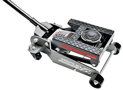

Old 04-03-2017, 12:07 PM   #50
Infern0
Bring It
Infern0's Avatar
Drives: In Between
Location: San Antonio, TX
Posts: 2,929
Originally Posted by ChevyRules View Post
Note the type of lifts..... Using a floor jack? It points to using the pinch welds and that one rear cross section. Four point lift? It's safe to lift by the points you keep on pointing out. Exactly the same points as the Camaro.
Originally Posted by 00 Trans Ram View Post
Yeah, but look at the type of floor jack it's showing. Specifically, look at the pad on it. It's not a pad, but more similar to what you see on scissor jacks. If you have something like that (notched), then use the pinch welds.
Also look at the top of the image. Both the front point as well as the side points indicate (with arrows) the floor jack is safe for those locations.
My beast: Powerbuilt Triple Lift. The center puck is removable if you want to use the platform instead.
Infern0 is offline   Reply With Quote
