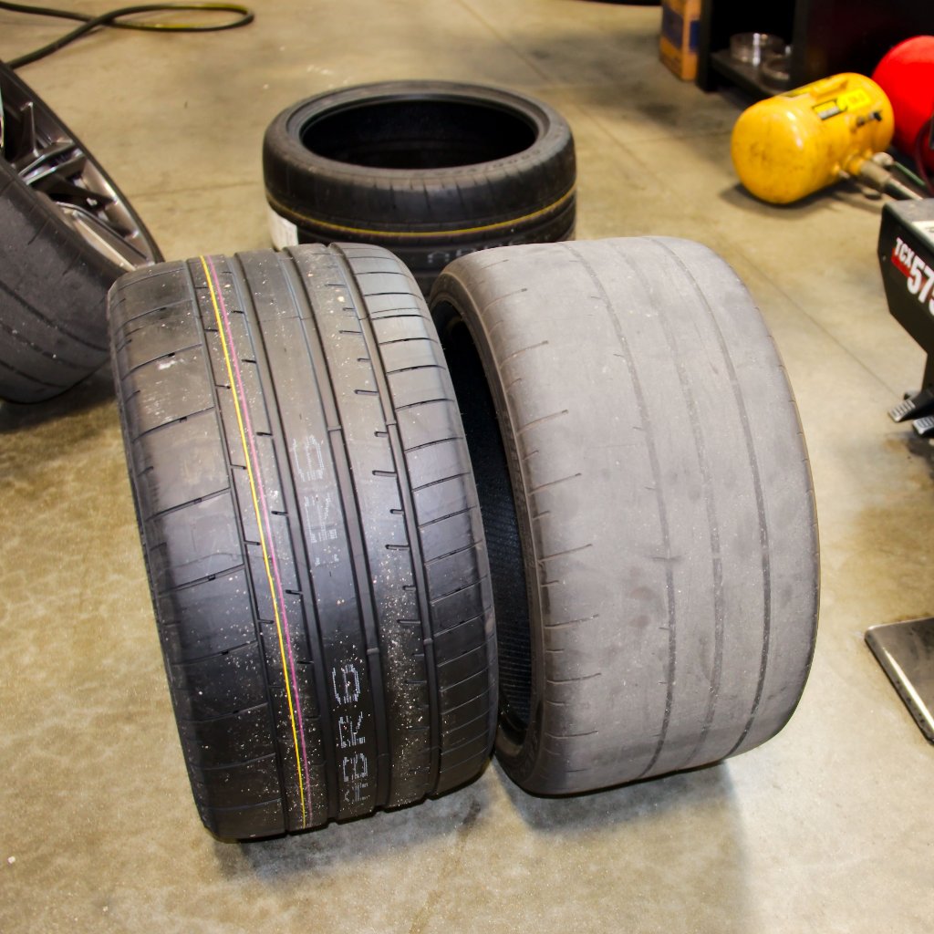

Had to get some new (stock) Goodyear rubber. The old ones might have had one more drag strip session in them but by now they had grown hard and slippery. They'd spin at the drop of a hat. I'm thinking that the properties of the rubber have changed after all the heat cycles they'd experienced. With 37 drag strip burnouts and over 20 practice sessions these tires have been heated and cooled quite a bit. Plus, without a garage I've had no choice but to expose these tires to sub-freezing temps from delivery to present. I noticed what appeared to be superficial cracks going across the tread (look close at the photo). That's why I didn't try to push them for those last few miles.

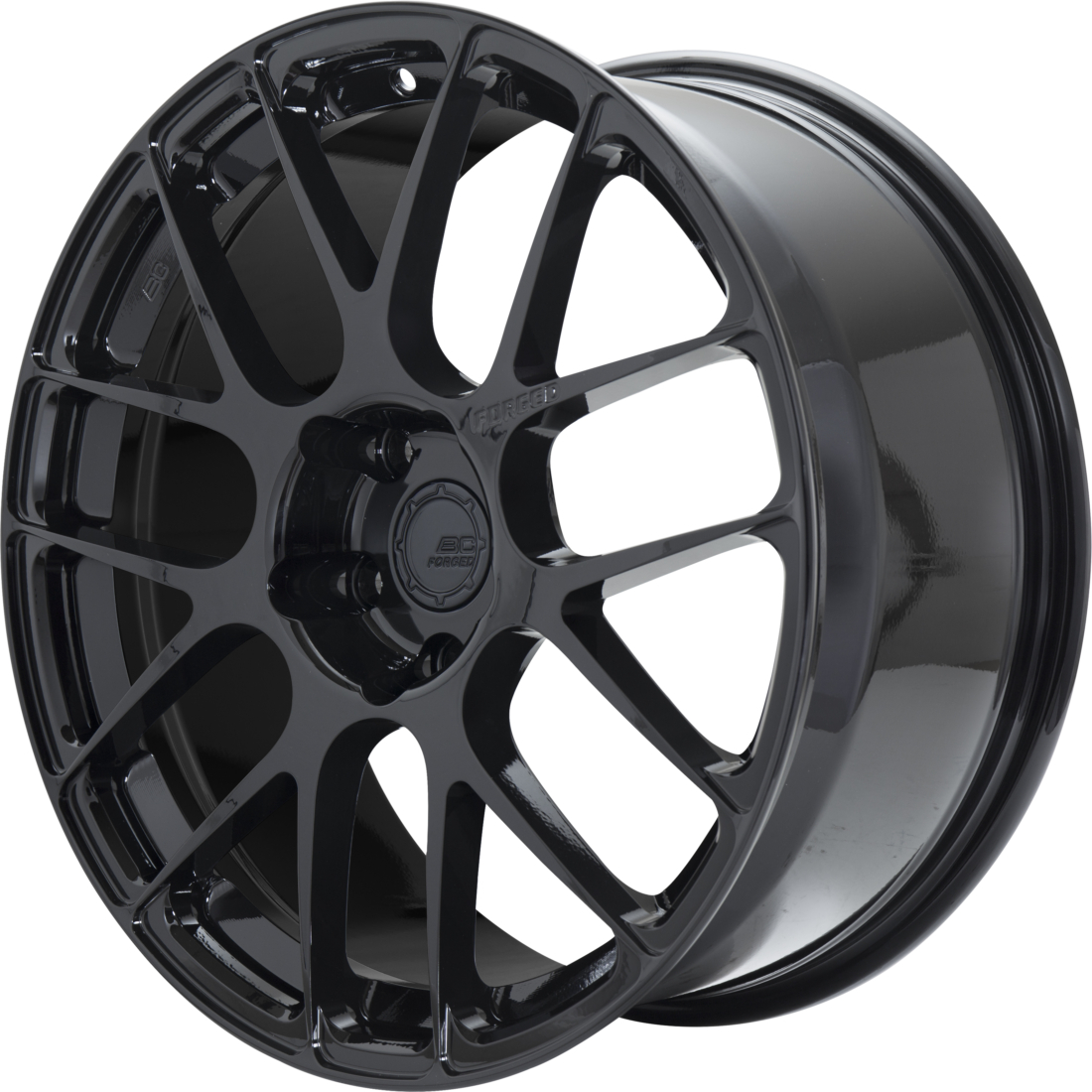

After ripping through my original rear tires, I took careful measurements, did a ton of research, and asked a bunch of questions. The questions I ended up having to answer myself. That's what I get for being first, right? Anyway, here's what I settled on. While pouring over choices I found this fitment calculator very useful.
Wheels: BC Forged (monoblock) RS40-14 18x12 w/ 43mm offset and high pad clearance. These are gloss black with 7 split-spoke design with matching lugs.
This was the only manufacturer that had sizes available that I needed (18x12) with high pad clearance. No one in the US offered anything this size without custom (expensive) builds.

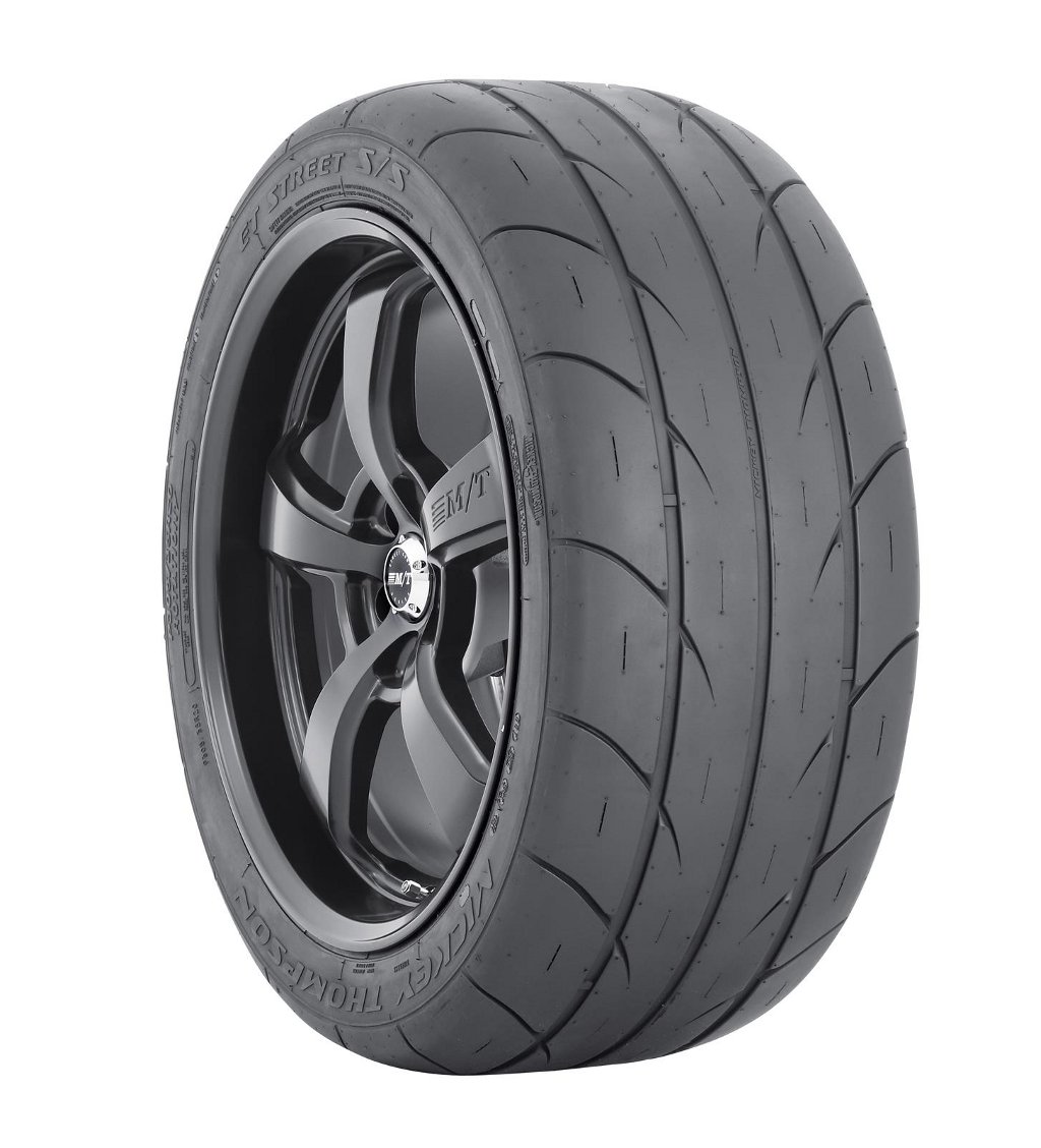

Tires: Mickey Thompson ET Street S/S, P345/35-18, Radial, R2 Compound, Blackwall. I really wanted to get the ET Street R that most of the racers in this discussion group seem to be using. However, MT doesn't produce them in my size. Their closest (P325/35R18) is an inch narrower and 1" shorter than stock. Not only would this have thrown off my ODO, Speedo, and shift points; but I would not be putting maximum rubber to the road. Nor would it maximize sidewall height for flex off the line. The ET Street S/S tire uses the same rubber compound as the "R". It just has street treads instead of street-legal slick slots. Granted, this puts less rubber on the track but the contact patch is wider. Besides, the wider tires look bad-ass! Hoosier doesn't offer anything close either.
Ended up ordering these from Summit Racing and having them shipped to PK Auto Design for $307.02 ea (free shipping). MT ET Street S/S P345/35R18

Nice but I don't know if those 12's will clear and with a 13.5 section width you will be close and never be ever to order
That 13.5" section width is at the center of the sidewall. There should be plenty of clearance there. The inboard wall of the wheel well is 3" away from the stock tires. The closest it comes to any point is on the front, inboard corner at the inboard radius of the tread where there is 1" clearance for stock tires. Tread width and tire height are the same as stock so I don't see any clearance issues there. This is why I took my time do the research.
I double-checked using this Fitment Calculator.
Thanks for the concern, though. I'll post an update after I install them.
