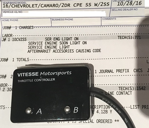

I wouldn't have brought the car to the dealership. If you get a low engine power alert & the check engine light usually the issue is either that the controller was calibrated wrong during install/set up or the electronics in the VTC got damaged.
If you disconnect the VTC and plug everything back into the gas pedal (like stock) you can drive the car normal again and don't need the dealership to do anything. The check engine light will go away after 6 key starts when that particular code comes up (P2138).
If you hit up Vitesse Motorsports they can help you troubleshoot it.
Originally Posted by SSFanboy View Post
I couldn't rip this crap out fast enough. My Engine light came on last night and cut most of the power to the throttle. Had to put on my hazards and practically drift all the way home. Even a Prius passed me like I was standing still. Maybe I got a bad one or maybe the dealership was looking for a scape goat. Either way, I'm going to play it safe and throw it out. I'm fine with pushing the pedal a little harder.

The Check Engine Light will always clear itself after 5 or 6 engine restarts, that if everything else is fine and the Controller is properly calibrated.
The Throttle Controller has absolutely nothing to do with the secondary cat deletes.
Any concerns with our controller, please send us a message / call us and we'll help you resolve it without having to go to the dealer...
