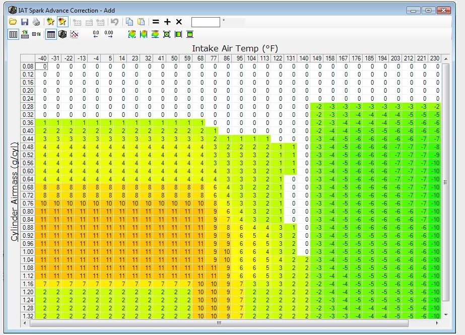

Haven't had much time to play lately, but I did a little educational searching last night. I found this Edelbrock IAT table from an older corvette. Somewhat surprised about how low of an IAT they start pulling timing. To me, this seems very conservative.
Name:  Ede;brock IAT table.JPG
I'm going to attack the heat soak/IATs sometime in the future. I've never seen this low of a table on a turbo tune. Is this normal for a PD tune? Since I'm in the 120 - 180 F IAT range on a hard pull, I'm probably leaving a lot of power off the table if the above table is representative of Edelbrock's conservative tune. (50+ hp?)

That timing table you posted looks right to me. Most tunes start to pull timing when IATs cross the 150° mark, especially on stock pistons. The typical weak point I've seen is the rings and ring lands. As the cylinder temps rise, the rings expand, and if they get too hot they'll touch end to end. With no where to go they start to deflect and will snap off the edge of the piston. On the HEMI we almost always see this on the intake side if memory serves. Then you got a 1/2 long 3/16th inch thick piece (or pieces) of piston flying around in the cylinder tearing up the heads and valves. Definitely better safe than sorry.
