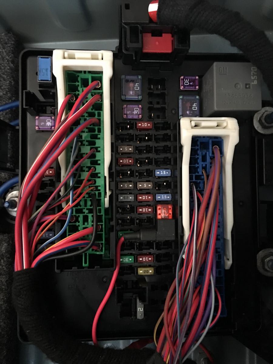

I used F19 (front vent seat) in the fuse box in the trunk for my switched 12v source. Not sure what the is since I have cloth seats.

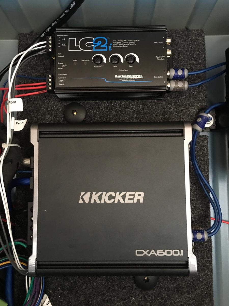

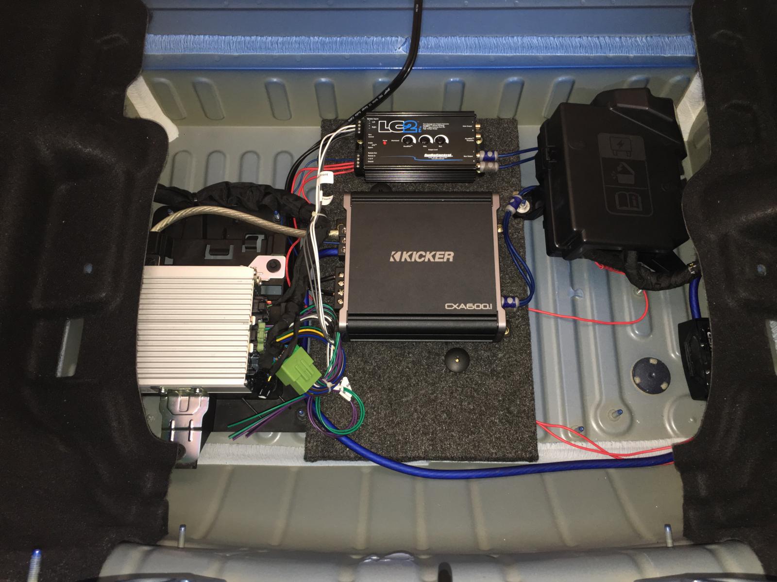

Here is my setup all installed using the Sub by Thumps plug-n-play wire harness. I use the factory ground locations for the AudioControl and Kicker amp. I ran the power to both at the battery. Everything sounds clean and the amp is receiving a clean signal from the AudioControl unit. I used the front speaker signal to get a full range signal to not choke the bass. I might end up installing some 200hz bass blockers to the door speakers to let the sub do all of the bass work.

Looks great Hyper1SS! Curious why you didn't go ahead and put in a 5 channel amp with a higher model AudioControl. Then you could have an aftermarket amp push your speakers instead of the factory amp.
I am happy with the factory setup just wanted to add a little more bass. Back in the day I would have but not in to loud crazy music anymore. I don't have my gains turned up much and now I got what I wanted.

Nice install. Did you pull that styrofoam piece out and put a board there to mount to? What it holding up the floor of the trunk?
Thanks. Yes I removed it. I made a amp rack out of MDF board and drilled holes to use the factory mounting locations that held the styrofoam down. The truck carpet side liners have a lip on them that hold the trunk piece up.

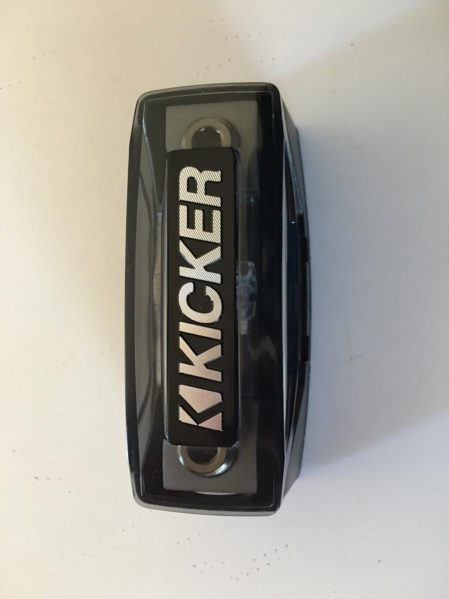

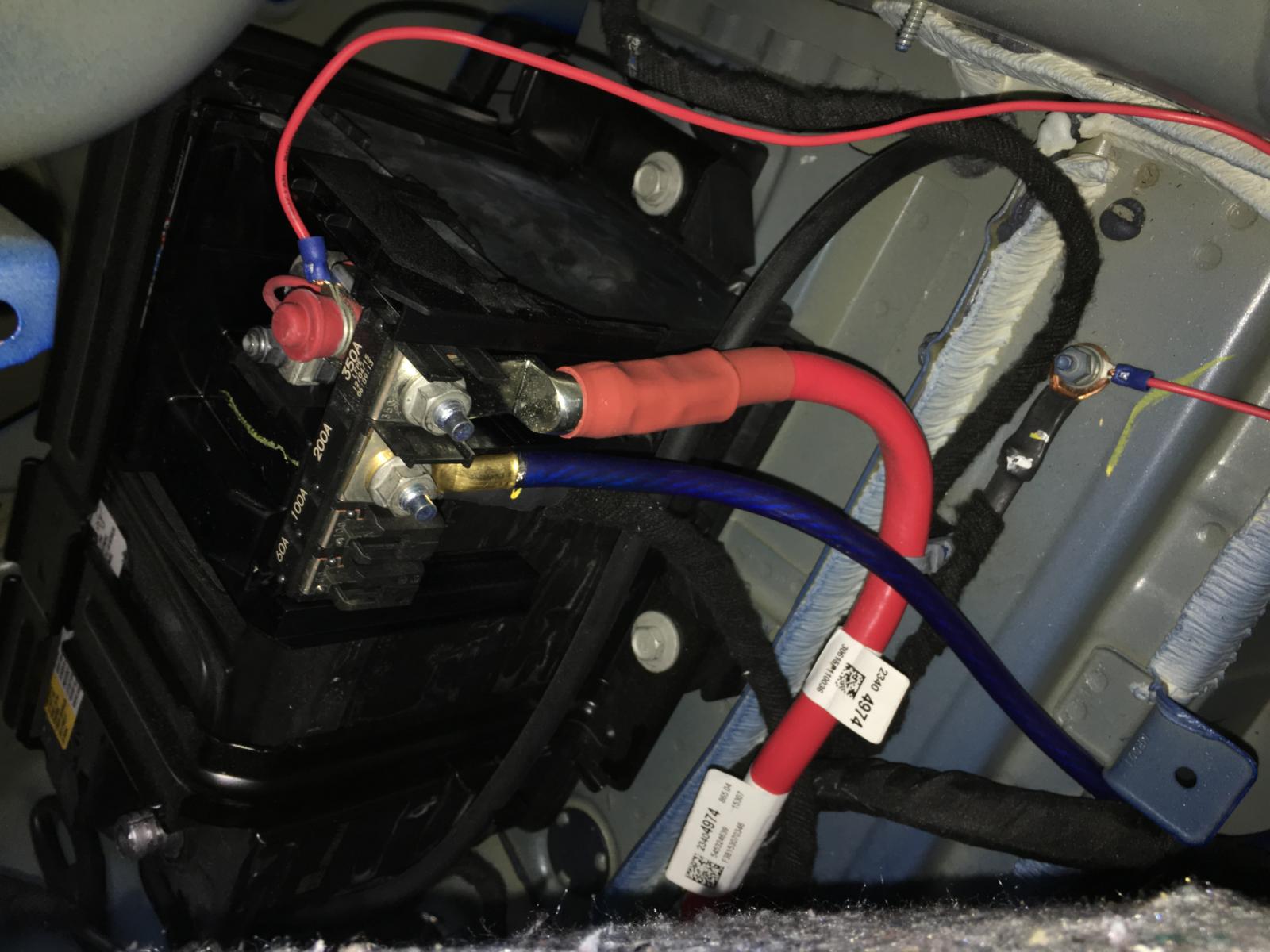

If you add a sub to any of our factory systems. Bose or Non Bose, you need to cut the wire that leads to the ANC mics or you'll have issues.
HyperBlue: do you have a fuse on your amp? I see that you tapped into the factory 200 amp fuse but I'd suggest that you use your own fuse for the amp.
Yes I do. I used a Kicker blade fuse block with a 80 amp fuse like Kicker suggested with 4 gauge wire. Where did you run your power wire to? Also did you use one fuse block on both amps or one for each amp?
