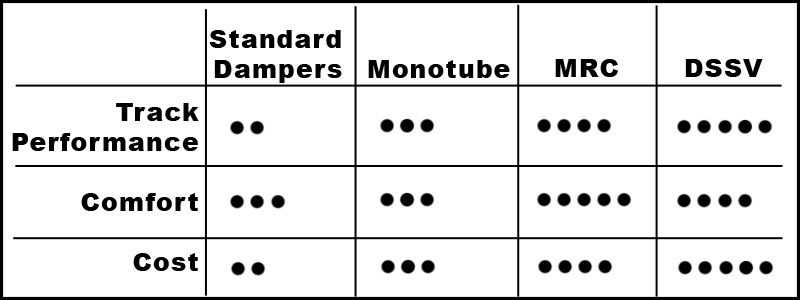

Maybe a visual will help explain it to some?
Attachment 771764
I totally understand and agree with those who feel MRC should not be standard equipment on the 1LE package...primarily because of SCCA regs and the general "illegal in competition racing" argument.
But I have a question for those "against" allowing MRC as an option...what in the 1LE's history or mission as a more track-capable SS makes MRC a "bad" thing? It's certainly an improvement over regular shim-valve damping (which is what we'd get...).

Wait, what am I missing. So didn't the 1LE have monotubes? The Z28 had DSSV, but I thought the 1LE with its monotones rides better than the Z28 with DSSV. Is it because the 1LE used the SS springs?
Correct it did have monotube shocks, and it was a softer ride than the Z/28. But the devil's in the details: the Z/28 springs were 85% stiffer than the SS. Springs do most of the work...dampers only control what the springs do.
Yeah, that makes sense. The only thing I could think of anyway would have been the springs.
So let's look at this from a different angle. Let's assume GM leaves the MRC unchanged, but makes it standard or something like that. Is there enough left on the table for the engineers to do enough to the SS, to make it a 1LE?

Is DSSV really 80% as comfortable as MRC? Ive never been in a vehicle with it
I think it has the potential, but depends on the entire setup to determine final comfort level. Like discussed above, the Z28 was more harsh due to the springs.
