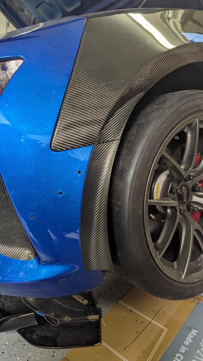

Originally Posted by eimarshall View Post
"Quick" update. I wrapped the tire blockers in CF vinyl and love how they look. They match the fenders significantly better.
Attachment 1148205
