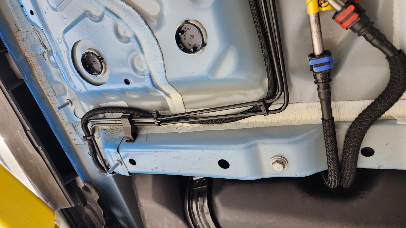

Just installed the pump today! It honestly wasn't that bad. The hardest part was connecting the lines inside the tank. There is just no room in there to get to the lines. You have to drop the exhaust and driveshaft down, then the tank comes out pretty easy. Just make sure the tank is empty because you have to pick it up over the differential lines (unless you drain and remove them), I was able to get the tank out with them still in place. Total it took about 4-5 hours, but I do have a low rise lift in my garage. I routed all of the wiring under the panels/heat shields up to the DSX pump controller.

Maybe it's just me but as a track rat who routinely drives over tall curbing, I can't get myself to feel comfortable with hoses routed externally underneath the car. I've seen way too many cars end up on fire for various reasons after an off track excursion.
When I get to the point where I need to supply more fuel I will likely pony up the $4,500 and get better injectors.
Otherwise, this looks like another solid product.
Not arguing, but none of that is really any lower than the OEM fueling, is it? It seems like there isn't the addition of more danger, or am I missing something?
Just asking
I'm no mechanic, but I think the main fuel line runs inside of the cage just to the right of the vehicle. When you lift up the rear bench seat you can see the red hose (I'm assuming that's the fuel line).
These other fuel pump are routed underneath the car.
...maybe a mechanic can set me straight.... because I've been on the fence about this mod.
What hoses are you speaking of? Our drop in pump reuses all OEM fuel lines.
The "line" I believe you're seeing is actually the wiring to his controller. NOT a secondary fuel line.
The Katech double pump drops in the tank and uses all OEM lines. It's not an auxillary pump like DSX offers.

Isn't that "line" the positive cable from the battery?... Maybe I'm not visualizing correctly.
