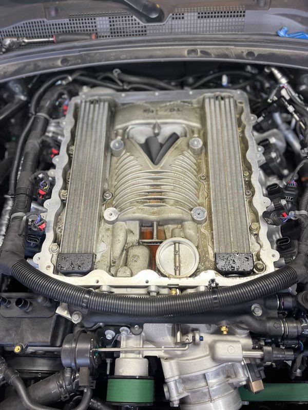

Correct but if the wrong length pushrods were used, it could have caused a valve to come in contact with the piston or were you saying that a piece of the actual head broke off? If so that would be Extremely rare and that would be a casting defect.
The head of the exhaust valve came off. Trying to post a pic but it’s asking me for a url
Yea, that makes more sense and still leads me back to a shop install error. The stock valves shouldn't have broken like that unless the spring tension was too high on the valve springs or the wrong size pushrods were used causing the valve to come in contact with the piston. Since you're telling me the whole head of the valve come off, I'm inclined to believe the valve spring pressure was just too much. That being said, it is possible that you simply had a defective valve from the factory, but so many people run aftermarket cams in these cars with the stock valves without issues.

Where did the coolant come from?
We are thinkng one of the intercooler bricks was leaking which caused this entire ordeal

Are you being led to believe this failure is because of a defective part…… I’m curious how many instances of leaking heat exchangers have been documented.

Posts: 3,557
Next to none that I'm aware of. All signs point to a shop error here since stock valves don't typically break and stock bricks don't typically leak, especially on an otherwise brand new 2023 ZL1. I feel like the shop is trying to place blame on a defective part rather than admit it could have been a mistake on their part so they won't feel obligated for any cost to repair.
Not saying it is but saying it is a possibility. Motor literally has 5k miles on it.

Posts: 1,522
Seems like the most likely scenario is valvetrain lost control and valve smacked a piston. What do the springs, valve seats and retainers look like. If there was coolant leaking from the brick and it got into the combustion chamber, it would have taken a lot of water to break anything. You would have seen a bunch of white smoke before anything. Although, that could cause detonation and break a ring or mayyyyybbeee a piston. But if the piston isn't broken and its just a broken valve stem, I think it was valve train control related.
Piston and sleeve is pretty much done as far as I know. I think the valvetrain is still intact. I highly doubt it was the intercooler bricks but it could be a possibility that they leaked. I did see a shit ton of white smoke come out of my tail pipe. All the coolant drained pretty much instantly as far as I know. Before it blew it was full
that would be my thinking. IMO there is no stock piece that can take a high lift cam and that would be valve seat, valves, pushrods, springs, retainers, rocker arm trunnions NADA. I went with a much lower lift cam with street ramp profiles, new solid valves from Manley, springs, retainers, Johnston lifters, each lifter was fitted with a custom length pushrod, rocker arm trunnion.
IMO no stock valve on a LT1 (LT4's Titanium intake probably can but out of my league) can take boost, high lift cam and E85 and racing, they were NOT made for the heat load. I'd look at Manley Inconel exhaust valve and a quality solid intake valve...
