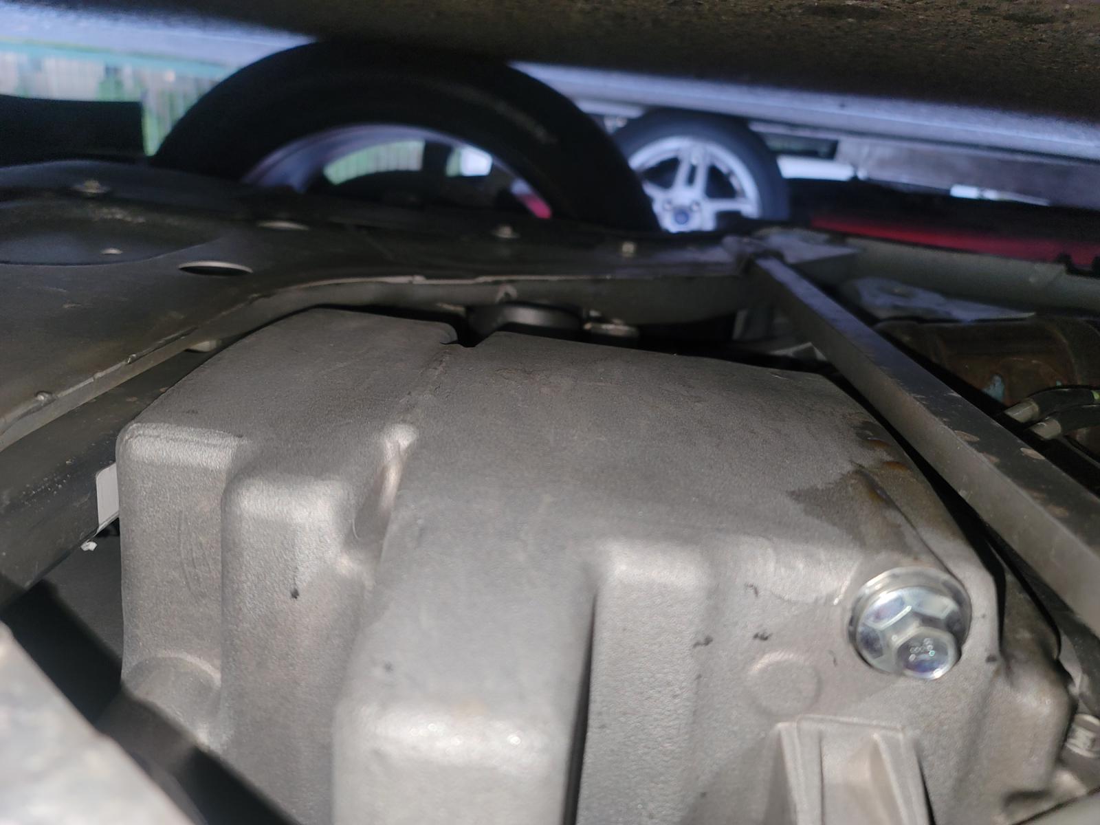

So today i look under my car this is what i found

Dont know what going on but i need to get under the car and have for myself because this mechanic dont know what there doing.. i still think there a hair line crack somewhere.

Could it possibly be, that they didn’t clean off prior staining/wetness? Probably not, but that would be my hope. I would slide under as best as I could, and wipe that spot as clean as possible, give it a bit, and then recheck that spot. Best of luck!

I will tomorrow. Going to use a camera that we use for sewer lines to see if i can spot something

Strange? The invoice says they did a 27 mile test drive after changing rear main seal. how many more miles have you put on it up until you noticed the oil re-appear? Other than hair line crack of some sort could you possibly have a defective pcv valve that is not venting your crank case properly, causing it to push oil past your rear main seal?

This leak always looked like it originated near the drain plug. I don't think that's the lowest spot gravity-wise, so not sure why else oil would accumulate the way it does.
Rather than throw a new rear seal on, I think they should've gone for new oil pan and plug.

This time the oil looks like it’s running down from above, if you look close by the drain plug it looks dry around it
