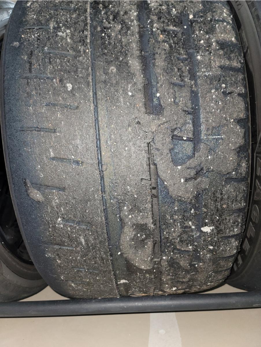

SS le is a formidable car - just look at the best lap time section in this site. With a slight amount of mods it’s going to be as fast or even faster than the ZLE on most tracks - especially shorter ones like lightning.
Regarding your tire wear - u are getting near zero wear on the inside - very opposite to my pattern. Yeah more camber would certainly help you. If the wear pattern continues I suggest you flip the tires on the wheel between track days..that will double the life for you

The outside of the tire shouldn't be wearing like that. Definitely dial in your camber + toe.
Did you turn the front struts to Track Camber? If so, I would set F -2.75 / R - 2.00
Do you have 0.05 Toe In F/R? Some folks also have good wear with 0 Toe F/R.

I think it’s your toe - I would zero that out in the front…

Cool. i'll try that before the next events.

Dont want to hijack the thread but I figured snice we are on the subject of SC3R I figured I ask. I bought a set of wheels with SC3R and my last track day I felt like they where not grippy as my other set. Could it be they had to many heat cycles? Even though they still have a decent amount ot thread. I also noticed they have alot of blueish tint around them.

Yeah those look shot. Blue-ing is caused by 'outgassing' and those will take a ton of heat to grip. If you're not at the faster end of the A group they will probably feel skittish.
