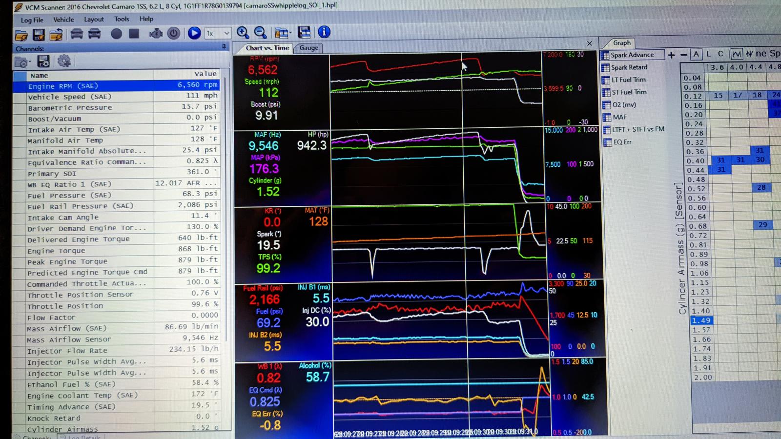

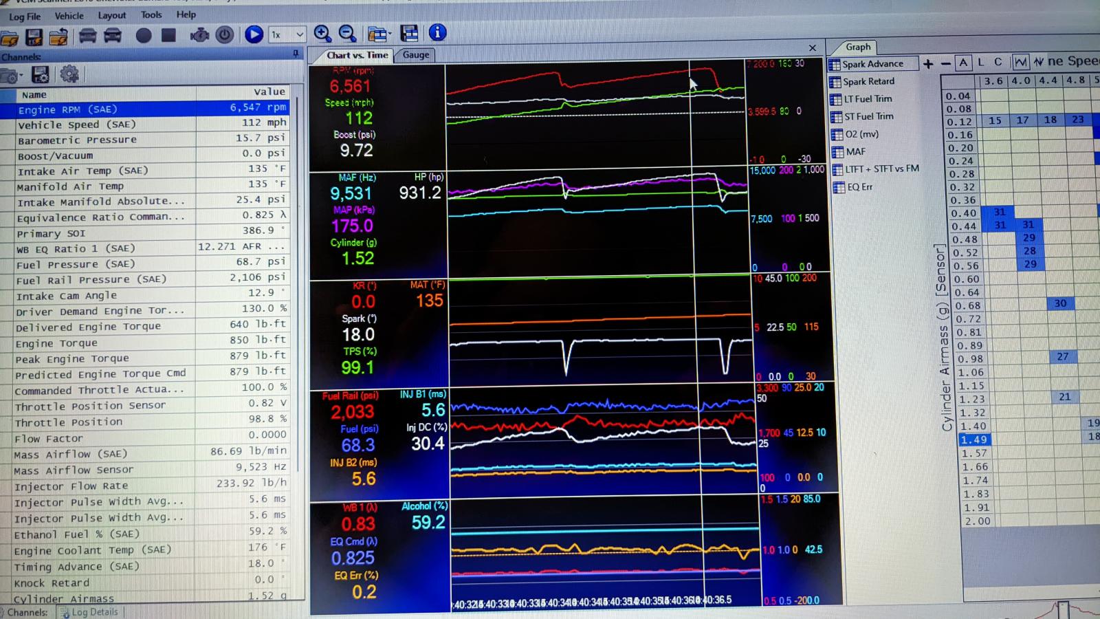

So I played around with SOI a little last night.
First log is with the SOI @ 386, second log is at 361. The AFR actually richened up and gained headroom because if you look I am giving it another degree of timing and it's making a little more power. it looks like injector ms might be a touch less as well.

Zero out the alcohol adder table and set the main SOI to around 370. Report back the results. I thought my post from above would give guys a better picture on what happens when you go above 370 on stock cam stuff. When I dropped my SOI back into the 360's it actually richened up even with another degree of timing. You just have to play with it and find what works best for your setup. My guess is somewhere in the 365-372 range will be optimal. On bigger cam cars you can get away with starting injection even earlier but stock cam stuff doesn't gain from it as Mike mentioned.
