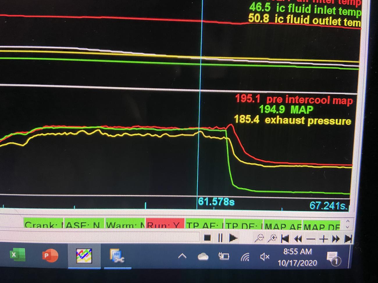

Posts: 1,678
Here is a little data. I need to recheck my exhaust pressure sensor. Seems to good to be true.
