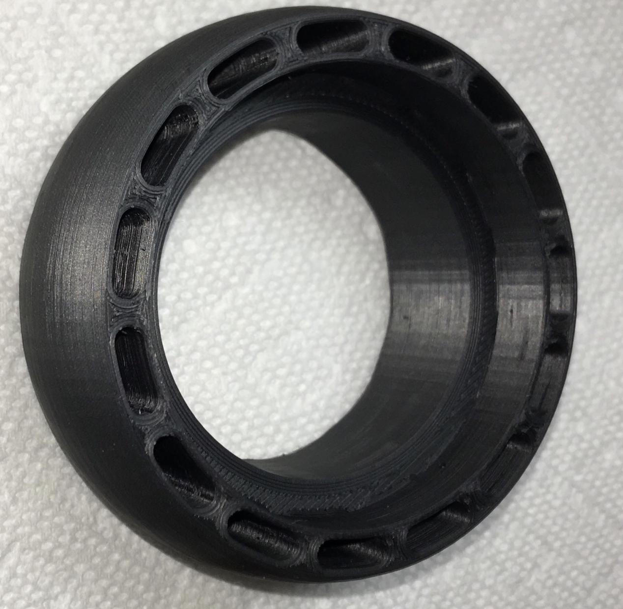

This pod directly replaced the stock vent/diverter. The factory vent/diverted is captured by a spherical bore (socket). The two halves of the socket are most likely fused at the seam during production after the vent/diverted is in place.
The trim ring is attached to the factory vent housing.
This mount goes inside of stock vent housing.
The gauge attached to the mount using the supplied clamp provided by the garage manufacturer. Slide the gauge through the front and the clamp in the rear has two plastic thumb screws the keep the gauge in place.

This one is yours.

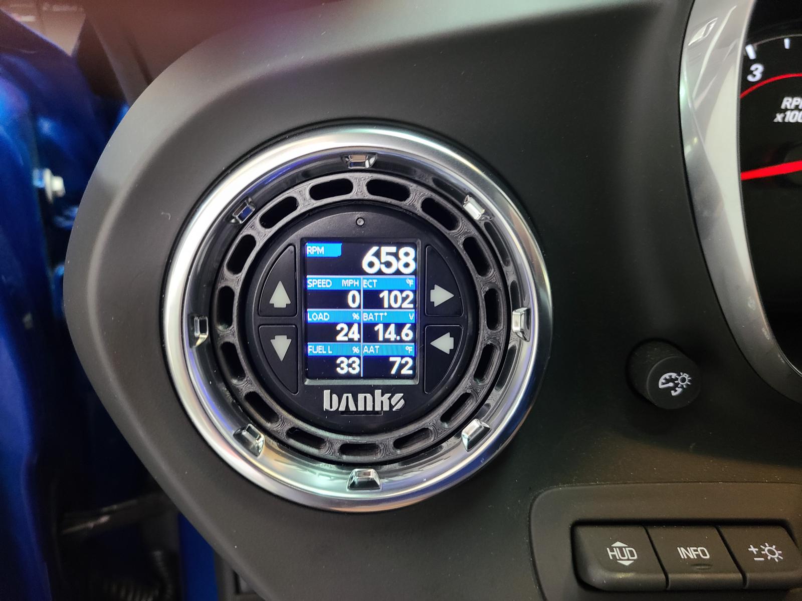

Just finished installing my Banks iDash. Thanks to Trochoidal for his help with this project.

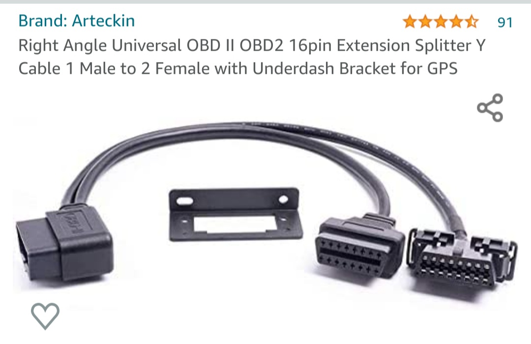

So im running the same i dash and Aem wideband. But I didn't wont to have all the clutter on my obd2 plug so I purchased a splitter on Amazon that I can hide the oem OBD2 port under the dash with all the gauges plugged in then I ran the splitter male to the original spot. A little confusing but not difficult.
Best part is you don't have to unplug anything if you wanted to connect an OBD2 reader
Right Angle Universal OBD II OBD2 16pin Extension Splitter Y Cable 1 Male to 2 Female with Underdash Bracket for GPS https://www.amazon.com/dp/B07L9ZK2DN...ing=UTF8&psc=1
