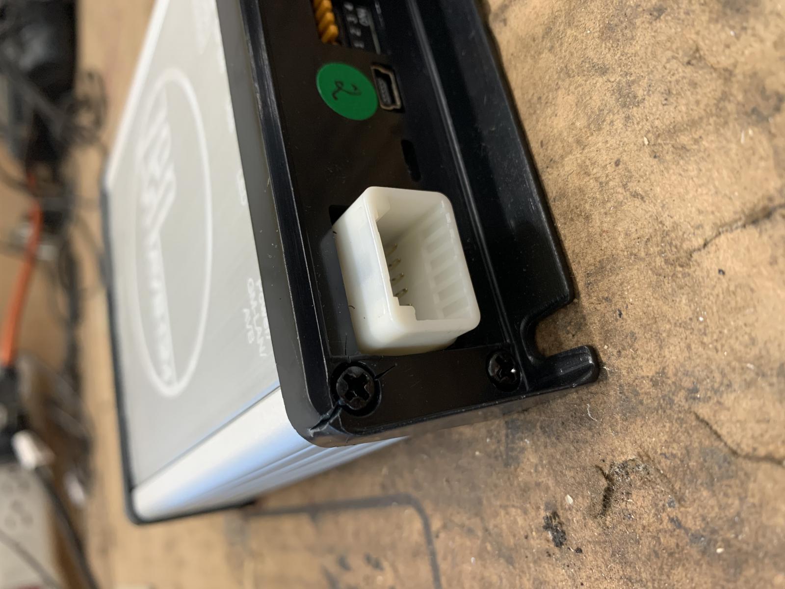

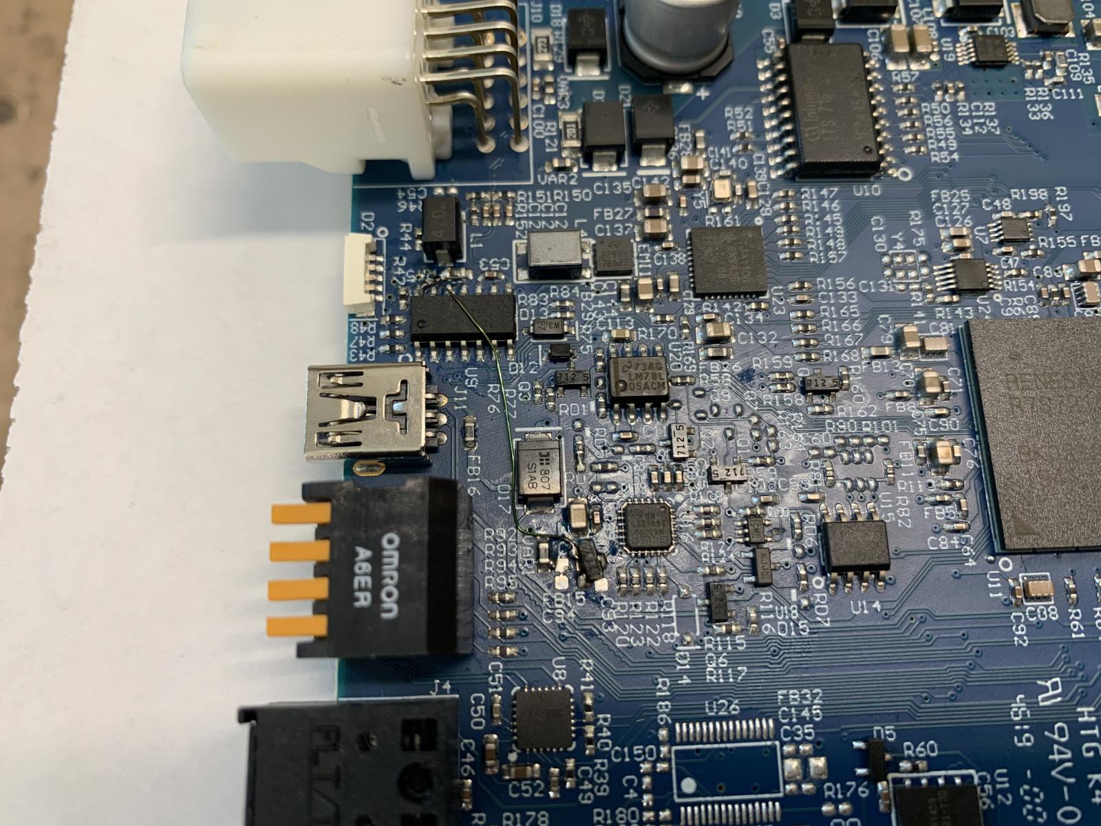

So I got my module back. Less than pleased. They put it together poorly. One end cap was crooked. The other had a broken screw hole from over tightening. While fixing it, I slid the board out to inspect. You wouldn't believe what they call a repair. Looks like they added a jumper from one leg of an IC to a nearby resistor, then jumped that with a single strand solid core wire halfway across the board to a crookedly soldered transistor/regulator of some sort. I'm somewhat suspect that it will survive the rigors of a bumpy road.
After much discussion with their support, they basically have a flawed PCB design and are unwilling to throw all of them away so they are reworking them like this and selling them. I guess the premium price doesn't get you a premium product.
They agreed to warranty the repair for life although I'm skeptical they would actually ever honor it.
It does seem to work for now. I haven't used it much so I don't know if the battery draining problem is gone or not yet.
In conclusion, I'm not sure if I recommend this module or not. If it weren't for the fact that it was the only option, I would say hell no.

It's a sad situation.
From my discussion with support:
Code:
So I'm assuming the plan is to rework your pcb design but are trying to rework these ones
Correct, and in combination with new software, that did seem to address the start-up issues.
ok, so how do I get a proper new pcb? I do not want this reworked unit.
I don't really know when we will switch to a new board. For the time being we have quite a lot of these boards.
so as you can see, they are shipping new units with these repairs and don't know when they are switching to new boards.
Kind of a crapshoot. Maybe PAC will make a module within a year. IDK. In my case, I had already converted my car to requiring this module. I would have to rewire a bunch of stuff again.
The module sounds great in honesty. I would HIGHLY recommend it if it wasn't for this repair. An electrical engineer friend said it was a poor repair but should hold. He recommended I epoxy the wire to the board to keep it from stressing over time.

That’s a good idea, I’m thinking when I go to order mine I will call instead of ordering on line and ask if they will verify the one I get is epoxied and assembled properly before they ship it.
Your engineer friend is spot on. I’m an electronic technician. Any time I use jumper wires on a board (which I really try to use only as a last resort), I glue it close to the board and bend it so it’s a minimal series of right angles between the two points instead of just loosely hanging like that.
