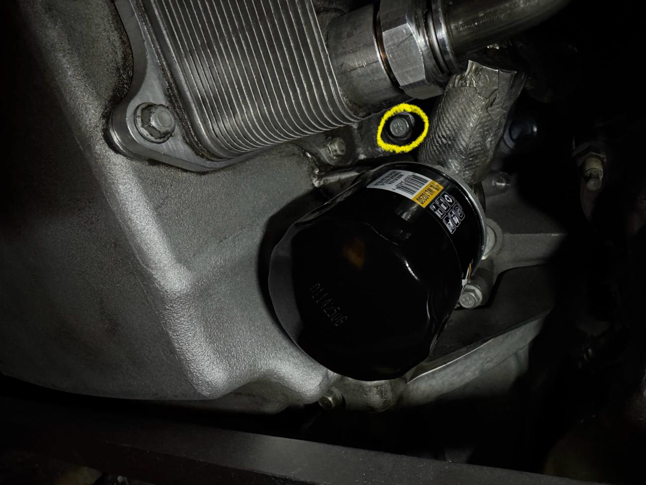

Anyone know the torque specs for this? I noticed it was loose and was leaking.
