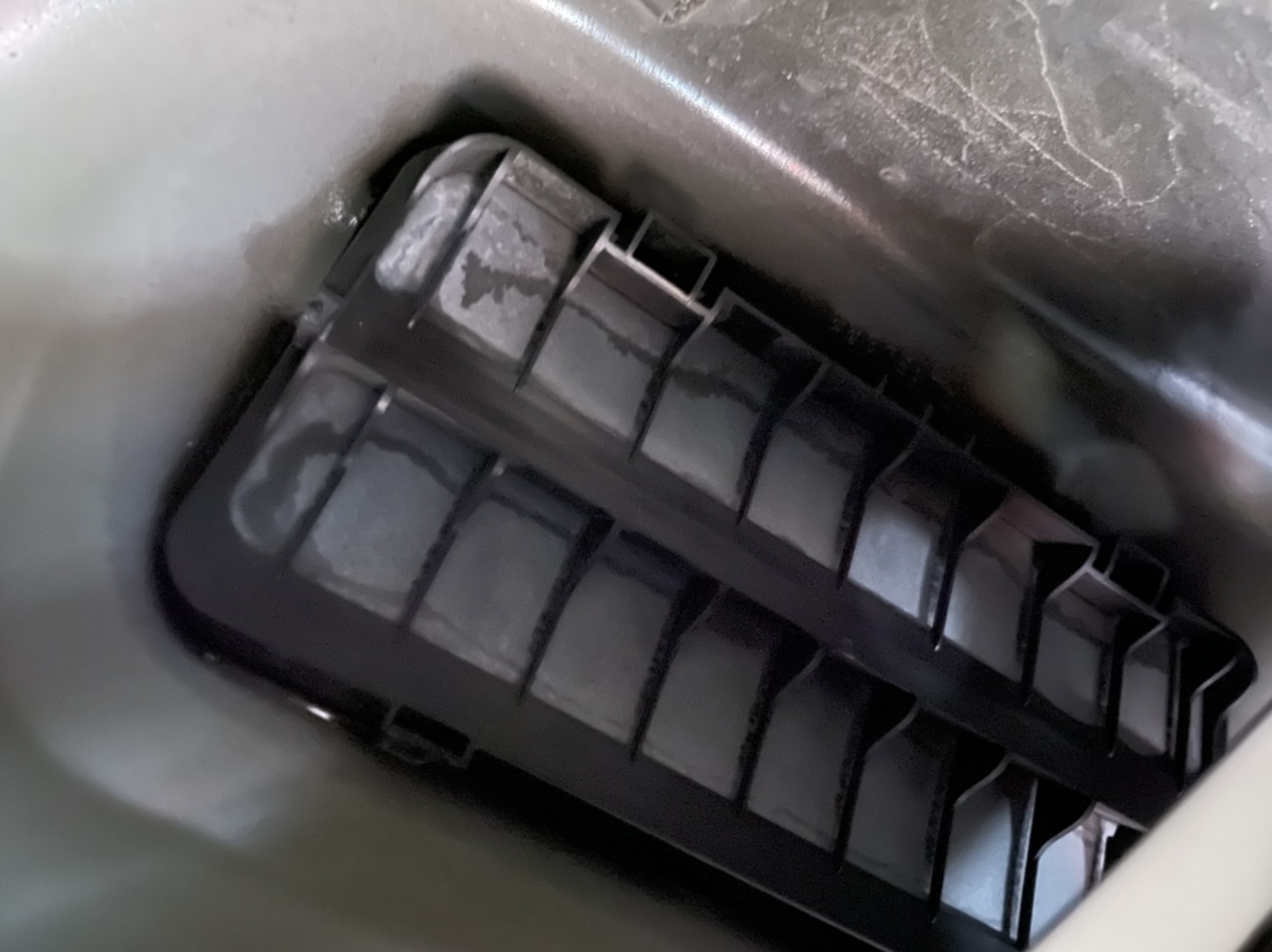

Thankful for this tread. I didn't want to buy an axle back and cut up the car, so playing around with getting more sound of the stock system. Unplugged the valves, have the rear seats down, and actually pulled the trunk liner and foam thing out that holds the tire pump, etc. Really sounds damn good now. The problem is I started hearing some wind flapping sound, exactly like the OP posted in the video.
Wish I could say exactly what fixed it, but I pulled the rear wheels off, pulled the rear fender liners loose, and pulled the rubber flappers off of the cabin vents. But while I was under there i also pulled several flappy stickers off the springs, and some diff cooler lines, as well as some loose black tape off of the shock covers. My guess is the rubber flappers on the cabin vents was the cause.
Back together and quiet at 60+ mph in 6th, which is the only time I heard it before, but it was freaking annoying on short trips with the wife. So glad OP put this post together. I have been chasing ghosts for a few weeks, and just found the post this am.

For all interested, I got the problem mostly fixed...the flappers noise was noticeable at 80-90 km/h. If the AC was on then noise was gone...
The Opel (in Europe they are responsible for Chevrolet maintenance) mechanic used some light weights (5-10g) on the flappers. This allows to drive up to 150-160 km/h without any noise. Above that you can still hear a bit, although nothing major.

Have my trunk apart for a sound system install and found the top flap things are rattling on both sides. Going to try lining the surfaces with Tesa tape and see what happens.
It’s going to be tricky because I don’t want to remove the bumper!
Old 05-25-2021, 10:32 AM   #36
WhyUMad1LE
Drives: 17 SS 1LE
Posts: 1,920
So I fixed the rattle by applying thin weatherstripping to the plastic area where the edge of the flaps rest. The downside is that now the flaps are always slightly open. I had to apply 2 pieces of weatherstripping per flap; one for each end.
