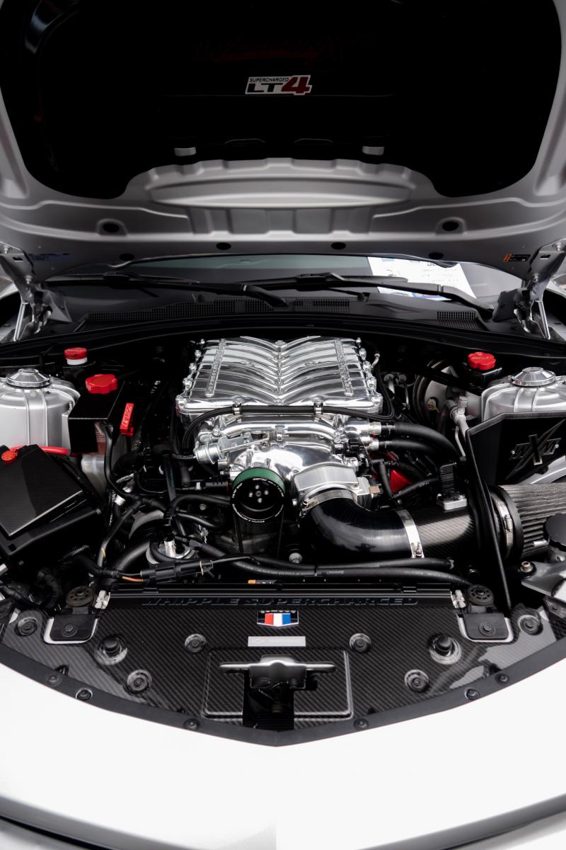

Whipple
Intimidator is offline   Reply With Quote

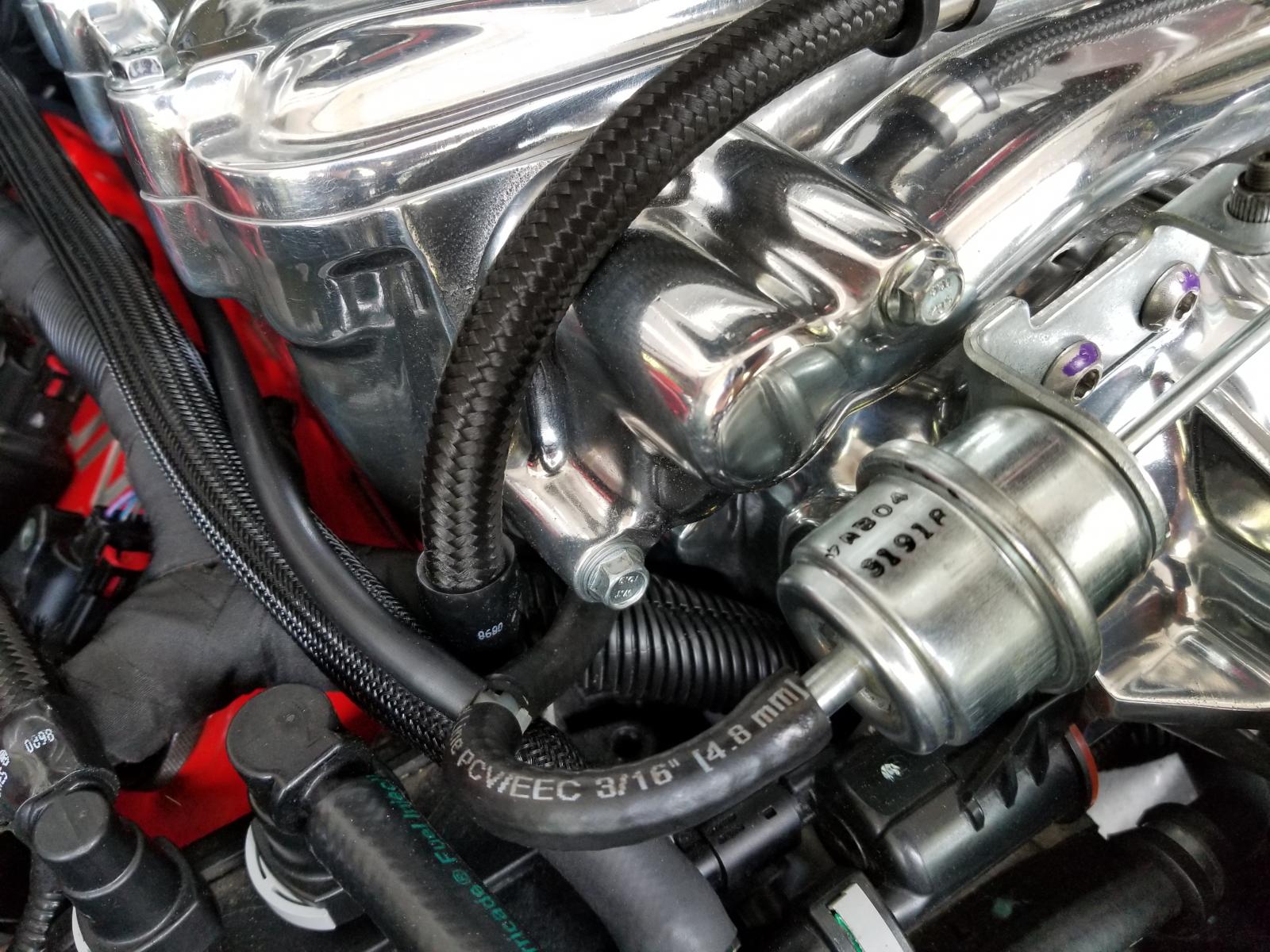

Originally Posted by Intimidator View Post
Whipple
They just tie wrapped the factory one to the hoses. Did they cap the lines or leave them open ? Thanks for the pictures
Whipple
This is the piece I’m trying to see.

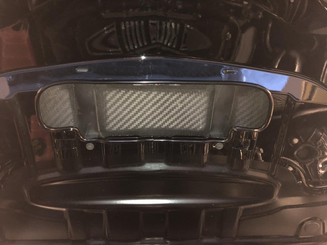

For anyone wanting to know about the cut out in the hood. This is the drawing and I had a template made in vinyl to make is simple. Bought a body saw and fine tooth blades to make the cut as clean as possible and door edging to finish it off.

Originally Posted by Alain View Post
Exactly What piece of the hood needs to be cut?
The underside of the hood insert?
It’s just the insert piece. It was easier than I thought. It just unbolts. I covered everything in painters tape and marked it all out in pencil and put the sticker on my marks. Here are pictures. Whipples direction need to be better. Doesn’t look out of place. Larger radius on the small turns would have made the edging go on easier. If I ever wantyto go back I could just buy the insert piece and nobody would ever know.
