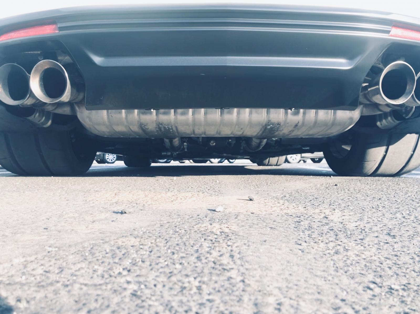

Originally Posted by Vettethret View Post
I'm like a junkie, itchin for some of these azz shots with the 345's?
Let me know if these help.

Looks killer!!! Your weld/mt setup is awesome. What rim/tire sizes are the et streets?

Bad ass! Do you have any pics further away from the car so you can see the stance of the back? Nice ride

Thanks.
305/45/17 17x10

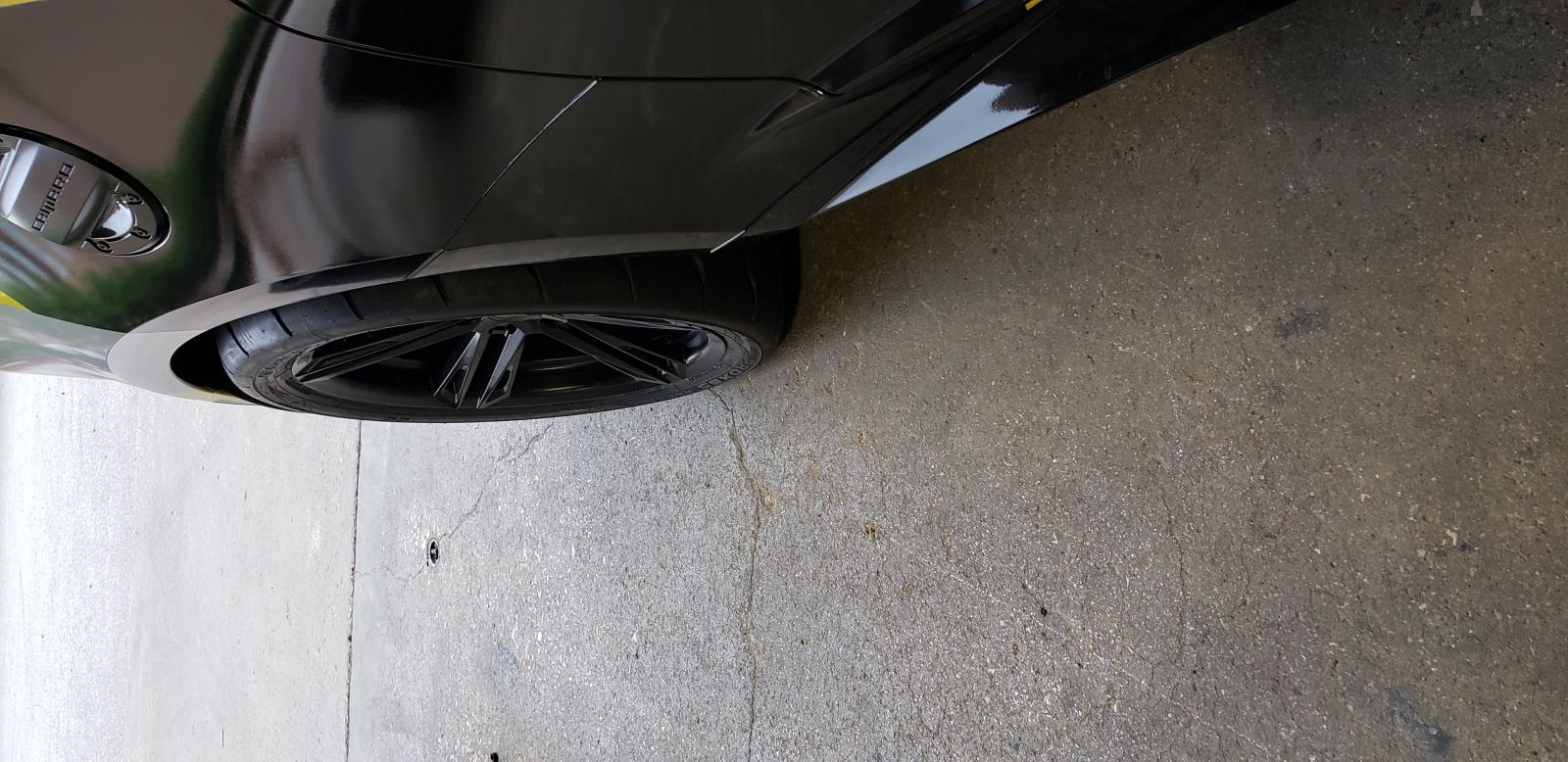

They fit! Poke out a tad.. but the traction is 10x better and I still can haul butt around corners!

Does the front rub if you max turn? I know my stock 305 on the 19x11 are so close I can’t ecen fit my finger in between tire and inner fender liner

No.. 305 should not rub unless your running over 30 in height or wrong offset. I've been ok with 14 to 23 offsets the 11 offset like the OEM zl1 do take a spacer on some cars and will usually take grinding the shock/strut mount especially if running some camber.

I just looked at my ZL1 1LE the one day when I had the wheel max turned to install the side markers and there wasn’t much room behind the tire at all so was just curious. Stock 1LE rims and Tires
Derp just realized you stated 305/30/19 front. I know someone went 325/30/19 front and 345/30/19 rears that’s what I was wondering was the increase tire size upfront having issues
