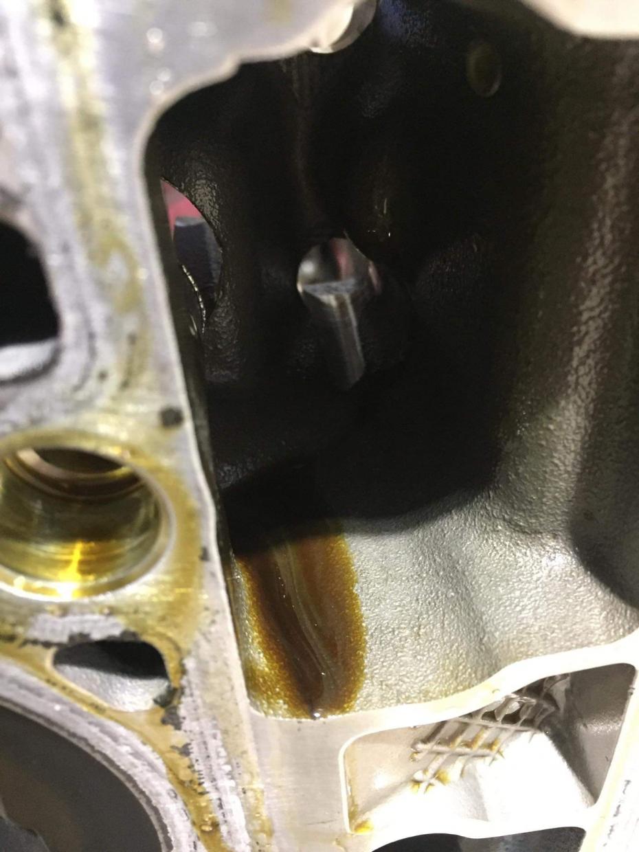

Originally Posted by bobby35ny View Post
Those valves are pretty clean.

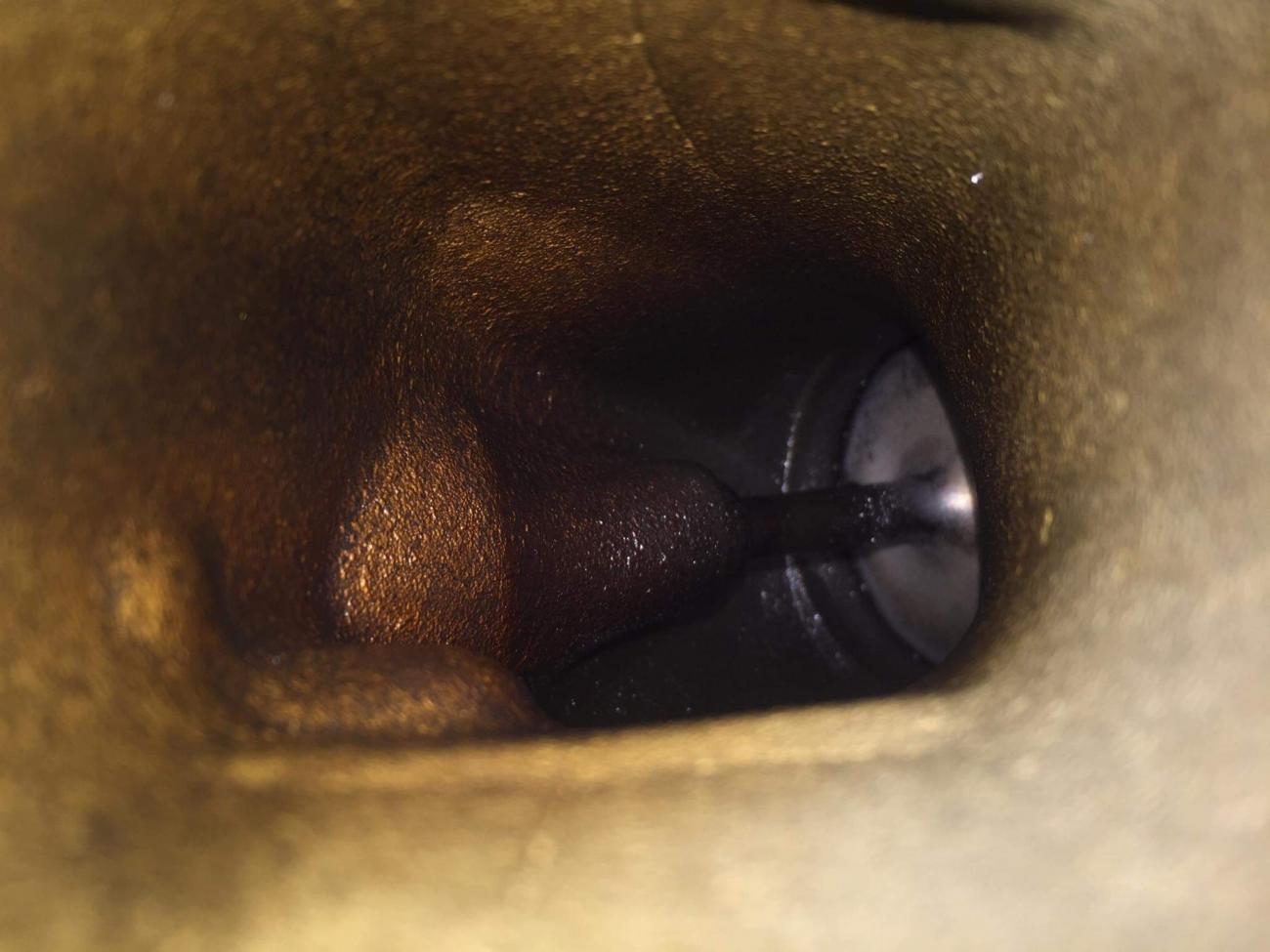

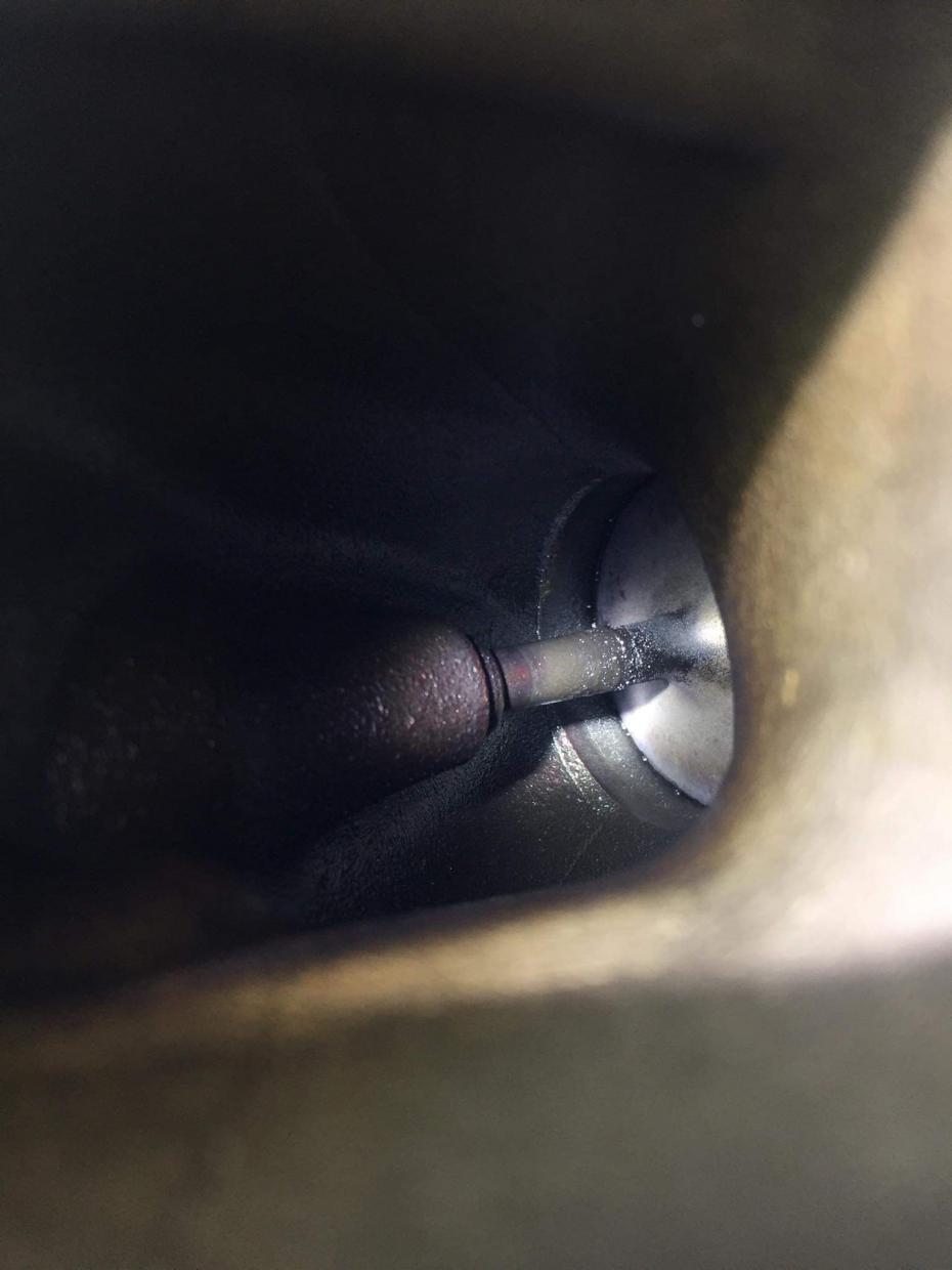

Here ya go... 21k miles.. 18k with no can.. 93 octane always..
Looks pretty clean to me~~

+1 yep.
And we know EDFHOBBIES ain't grannydriving his Z
This is great info. Thanks.
Feeling even better about skipping the catch can fad.
Thanks! Finally, something to actually reference. I'm not seeing an obvious issue with coking here. Will probably skip the catch can based on this. Not worth possibly screwing with my warranty.
