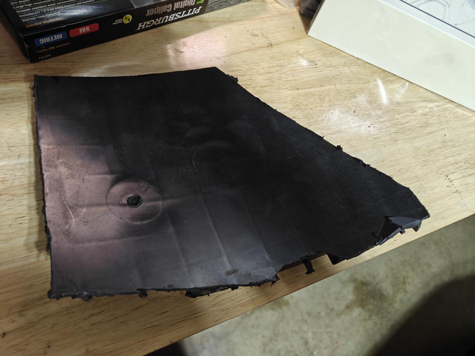

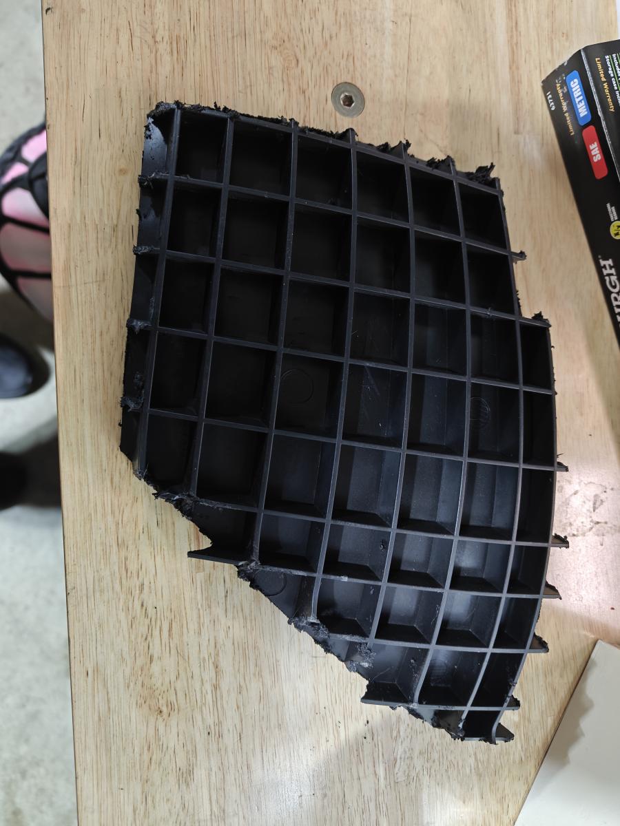

This is a crazy old thread but there is still relevancy to it.
I should preface any of this by saying that I did not do this mod for any perceived audible increase of the blower, I already have enough as it is, but I did it just to see if it did anything to my set up because at my power levels there was a high chance that I am/ was being restricted with the factory unit as has been discussed ad nauseum in other threads involving the RF intake and similar.
As it turns out, Callaway was onto something and EDFHobbies opened up the floodgates on it entirely.
All things being equal outside of this mod, doing this and this alone gave me a 5% increase in fueling (ie there has been a change in airflow to where things are getting more air than before) up top in the RPM band and the power gain was so considerable that it actually knocked out my high side fuel control to point where the HPFP needed some tweaks done to it in order to try and reign it back into proper control.
Previous HPFP running degrees up top was about 102* max during my run. This run took me and capped my HPFP to 130* duration and sporadically dropped out fueling after that due to the fact that it topped out.
MAF frequency also increased by 106 Hz up top.
Peak boost pressure increased by 1.41 PSI and stayed fairly consistent up top as well.
Oh yeah, I forgot to mention that where I used to be within 3% fuel control at idle which is incredibly clean on the fuel trims, doing this mod changed that to where the trims are now sitting between 10-11% LTFT's, which is by all accounts dirty.
The mod works, but it works considerably better on an engine that requires the extra airflow to see any sort of benefits from it.
GM did a great job on the factory set up, the issue is once you start going past factory power levels, it becomes a bottleneck, but you can still revise it similar to what Callaway, Hawk, and EDF did to allow your engine more breathing room if that's what it requires, otherwise the factory unit is good to say about 650 RWHP (at most, more than likely it's probably only good to about 600 RWHP) before you have to do something about it if you want to keep it for whatever reason.
Just figured I'd update this for anyone currently on the forum using the factory set up or for anyone who likes looking/ knowing about data changes based on hardware changes/ revisions.

Addressed the high side issues in tune and reflashed. Finally was able to get out for a run to see where things would land not expecting too much out of it all... Here's the data as follows:
Before intake mod
723.5 RWHP
765 Ft. Lbs RWTQ
After intake mod
752.2 RWHP
794 Ft. Lbs RWTQ
With saying that, as it turns out, the 5% gain in fueling was worth 28.7 RWHP and 29 RWTQ. Which by all accounts are impressive results based on a very straight forward change to the stock intake alone. The gains obtained from this mod are the equivalent to RotoFab numbers with the hood down. Power drop off doesn't seem to be as prevalent after 6100 RPM before for the set up like it used to be, which tells me that indeed the intake was choking things out up top. The car seems to respond better all around and even under low effort driving conditions (stop and go traffic etc.) it seems to feel a lot happier now with less hesitations and weird little quirks that it had before. Things are just smoother overall.
All other data points remained close or similar to the previous post, the only considerable change being the high side dropped down to 113* at its peak, so fuel control is well accounted for and well under control now.
I'm going to call this mod a success and I'm going to call the new power delivery this thing has perfect for the streets, which is where the car predominantly lives with many and plenty Italian tune ups to keep things clean and cleared out. As far as any road racing or general track duties are concerned, she's ready to throw down and hold her own, reliably and for many years to come.

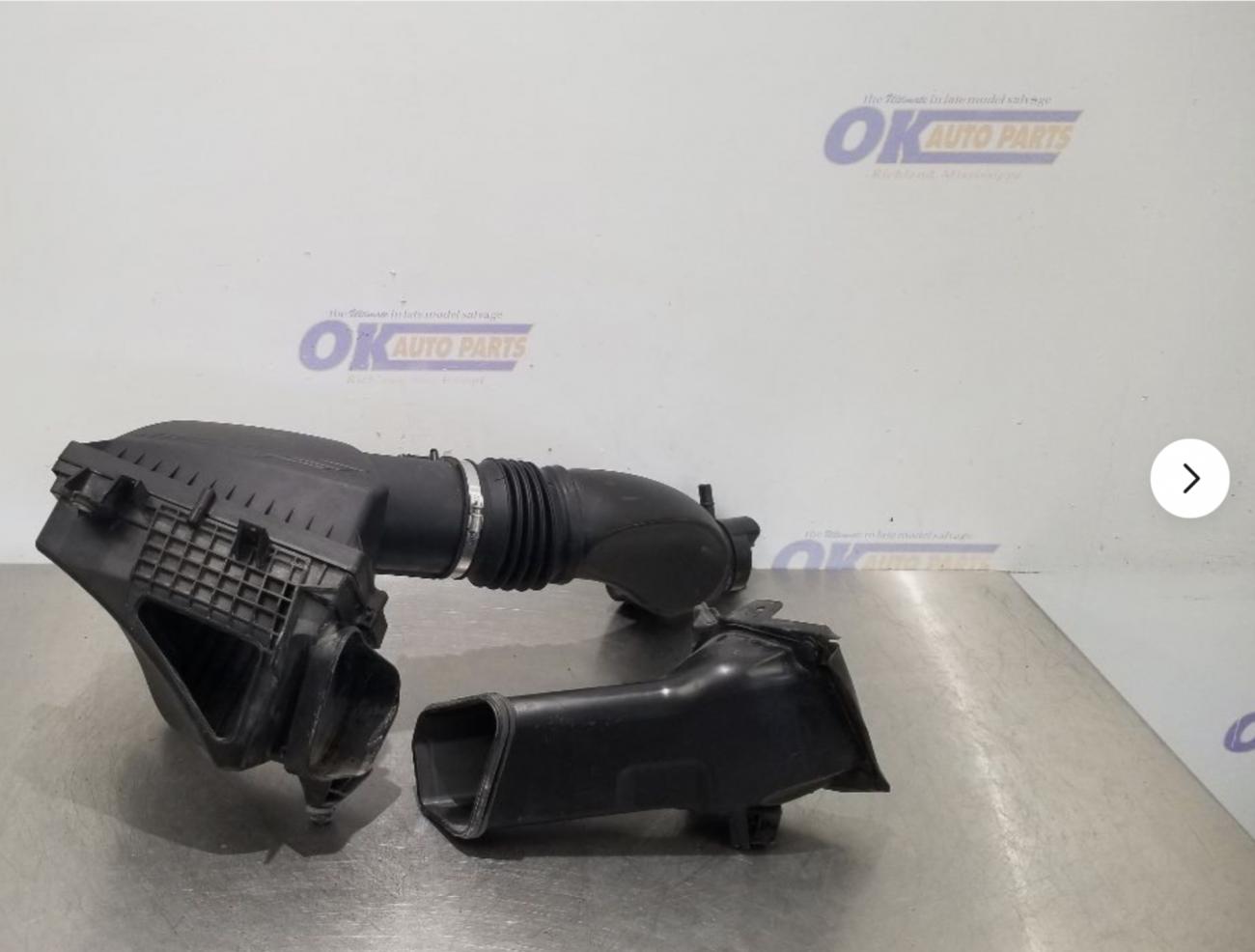

If you compare the OEM airbox on the Cadillac CT5-V Blackwing to the one on the ZL1, the Blackwing has an additional inlet near the passenger-side front fender. I’ve always suspected that extra airflow contributes to its ~18 hp advantage with the LT4—along with the wideband O2 sensor helping keep fueling in the optimal range.
You’ve confirmed what I suspected—and clearly, the Cadillac engineers felt the engine needed to breath better.
The other change is the intake tube is hard plastic instead of the rubbery tube used on the ZL1. No worries about collapsing under WOT.

It's crazy just how many refinements Cadillac made after the fact the Camaro rolled out. They were worth merit too because the results definitely speak for themselves.

106 Hz doesn't sound like a lot I agree, but when you are talking about frequency changes up top even a little goes a long way. The mod I did followed Hawk's and the only thing I did was go further than his cuts but not as far as EDF went on this box to preserve some of the boxes structural integrity. I didn't take a photo of the box but I took a photo of just how much I took off. It looks ugly, but I cleaned up the box once I finished my cuts, mostly at the ribs. Used a Dremel 3000 with the cut off wheel and a straight drill type cutting tool to dig into the plastic ribs. Then a small grinding stone to trim and smooth the remaining portion of the ribs which were exposed.
