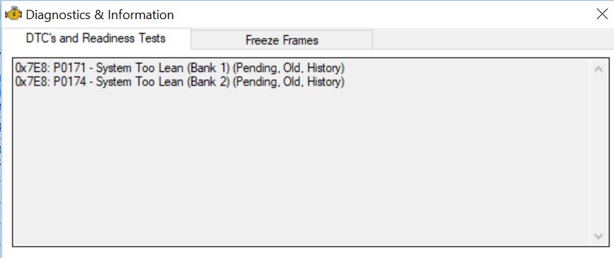

Well, I had an interesting situation. On Google, several of the gas stations around town have e85. It's not true. After visiting 3 locations, I pulled over and started calling. I found one and filled the first half tank of e85. I need to get some logging over the weekend.
A check engine light did come on:
Name:  codes after E85.JPG
I cleared the codes and will see if they come on again. I expect it was just linked to the first time running e. If anyone knows different, feel free to let me know.
