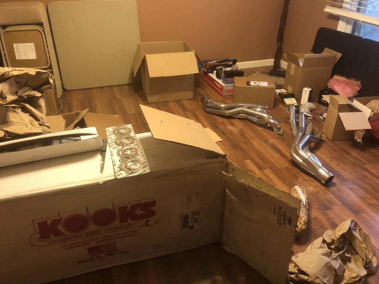

Going over all of the parts for the install today. We are expecting to have access to the lift and get things started in about 3 weeks. We had some scheduling difficulties. Regardless, it’s about to begin.
Only thing I am missing was the LS1 front crank seal. Also need new fuel lines.
The pistons from JRE look great along with the entire cam kit and headers. Fuel system components all look right and the gauges look simple enough. The smaller pulley 85mm and a belt (with spare). I have the HP Tuners pro kit in the house now so, I need to get it setup with my car. Should be fun to log my car while waiting just so I can play around with the tuning software. I am especially interested in the shifting aspects of my current tune.
Regardless, can’t wait to get the changes under way.
I also picked up the modern spare kit, while we have the car being put together, I plan on painting calipers and testing the spare tire on front and back to ensure it will fit as expected.
