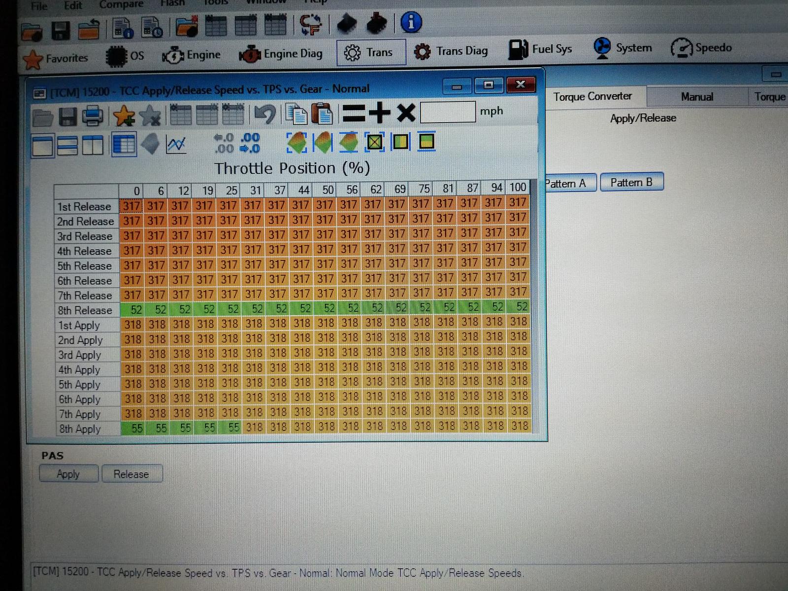

The only thing my A8 does is shift fairly hard on the initial 1-2 after a cold start. I am sure that by setting my converter to not lock until 8th gear @ 55mph on part throttle shifts helps a bunch with some of the stuff you describe...it really smoothed out the transmission.

That and my torque converter is set to not lock part throttle cruising until 8th gear above 55mph. You lose some gas mileage but the trans acts sooo much smoother. Once you turn off afm, 0 out slip tables, and change lock up setting, the A8 is a dream to drive...
How do you have those lock up tables setup? Do you pretty much just put 318 everywhere except 8th? I'm new to all this tuning stuff so i'm trying to learn what does what haha.

Here is a screen shot of my TCC Apply/Release for Speed... set for all Patterns and Hot. I don't mess with Full Throttle lockup.

I'll give those settings a try. Is there anything negative about keeping it unlocked most of the time besides MPG?

Nope...this is how I have tuned all my GM automatic transmissions in the past. They only lock the converter in the lower gears to improve gas mileage. You will notice that its more responsive as the rpms will increase easier at tip in throttle which will also give a little more exhaust note. You can play around with different speeds you want the converter to lock. I like 55-60mph the best.
