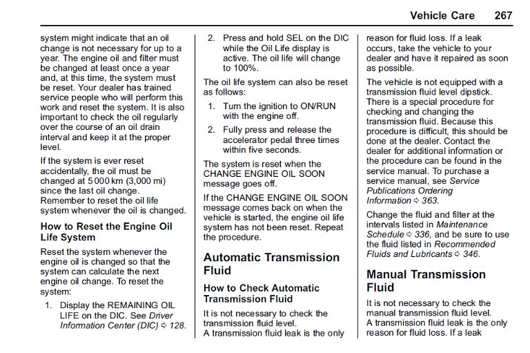

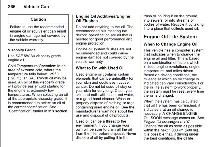

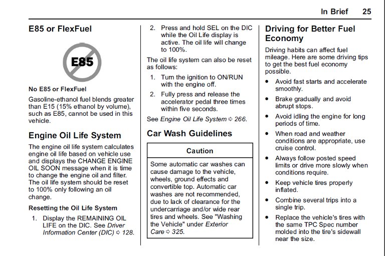

Posts: 779
Originally Posted by VAZL1 View Post
I tried to find some info on the oil life meter logic but was unsuccessful. My understanding is it takes several parameters into account to determine the oils ability to lubricate effectively. If your at 16% with only 2700 miles, something isn't right, unless you track your car. I would check the color of the oil if it still looks kind of new, something is wrong with your oil life sensor, if its real dark in color your oil life sensor is working and your oil needs changed.
Stephen12ZL1 is right but if you're like me, you like to see it for yourself in writing. Here's a link to an online reference:
GM recalibrates oil life monitoring system for 2013 and newer models [Feb 14, 2013]
The information can also be found in the Camaro Owner's Manual on pages 25, 266, and 267.
Page 25 has a brief description with instructions on how to reset it.
Pages 266 and 267 contain a detailed explanation.
--Cal
