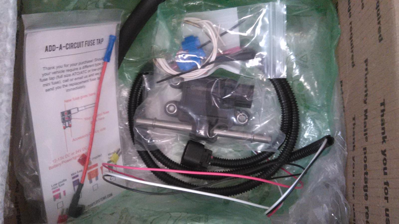

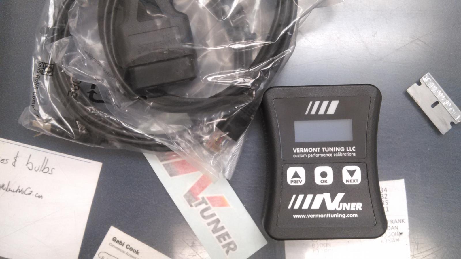

It has been a long, thought out decision, but in the end I went with Brian@Vermont tuning. He is the only one capable of functioning Flex Fuel for the LTG.

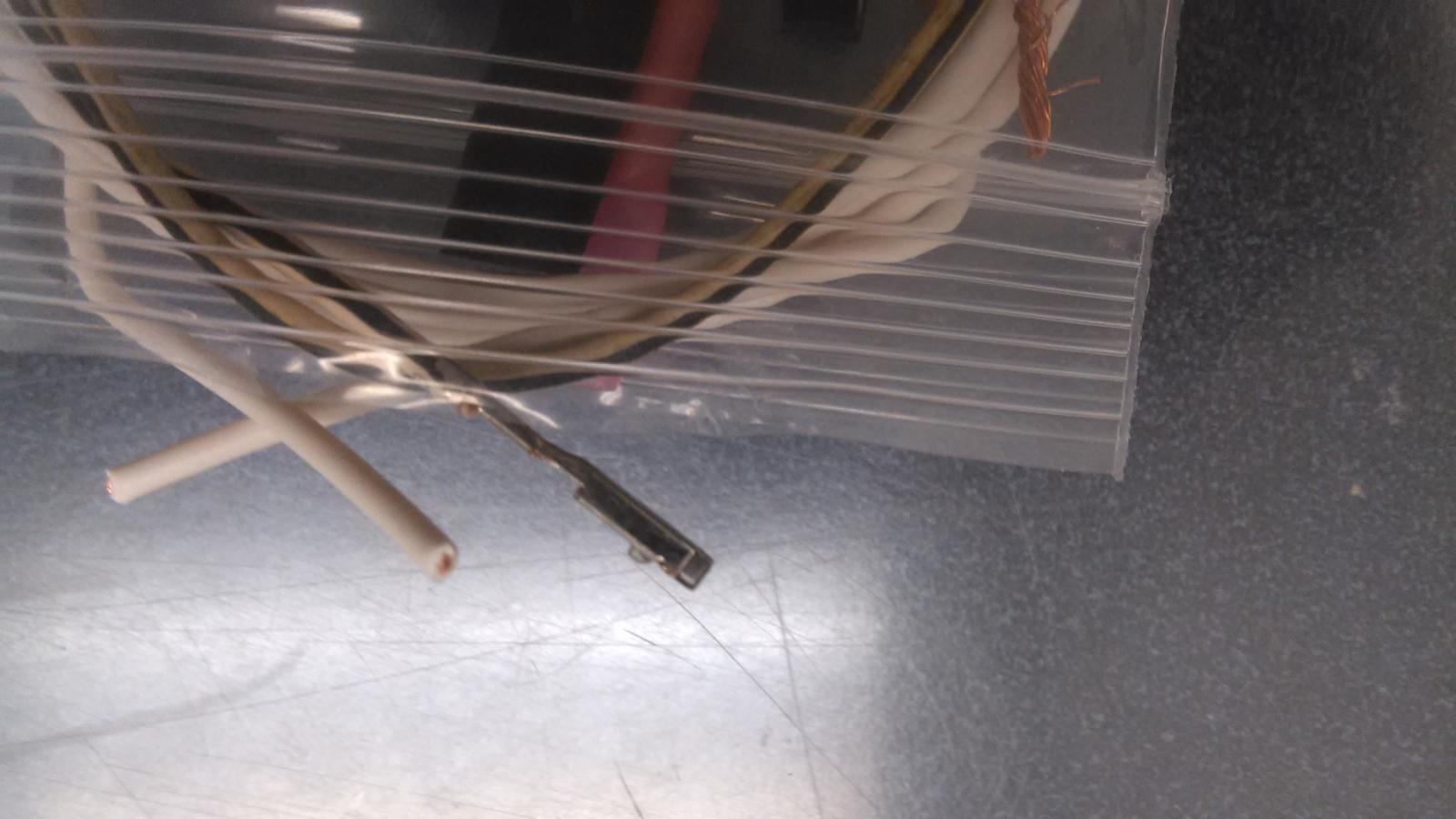

Everything looks great. Nice little touch here with the correct packard connector already included. Now I won't have to source one on the day of install!!!
