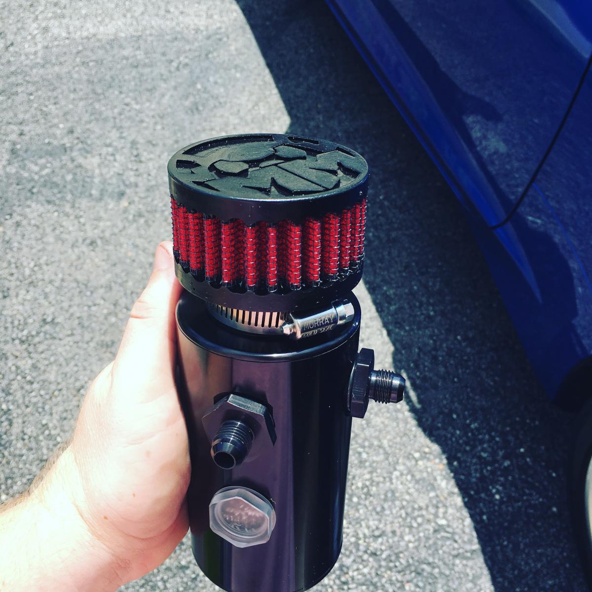

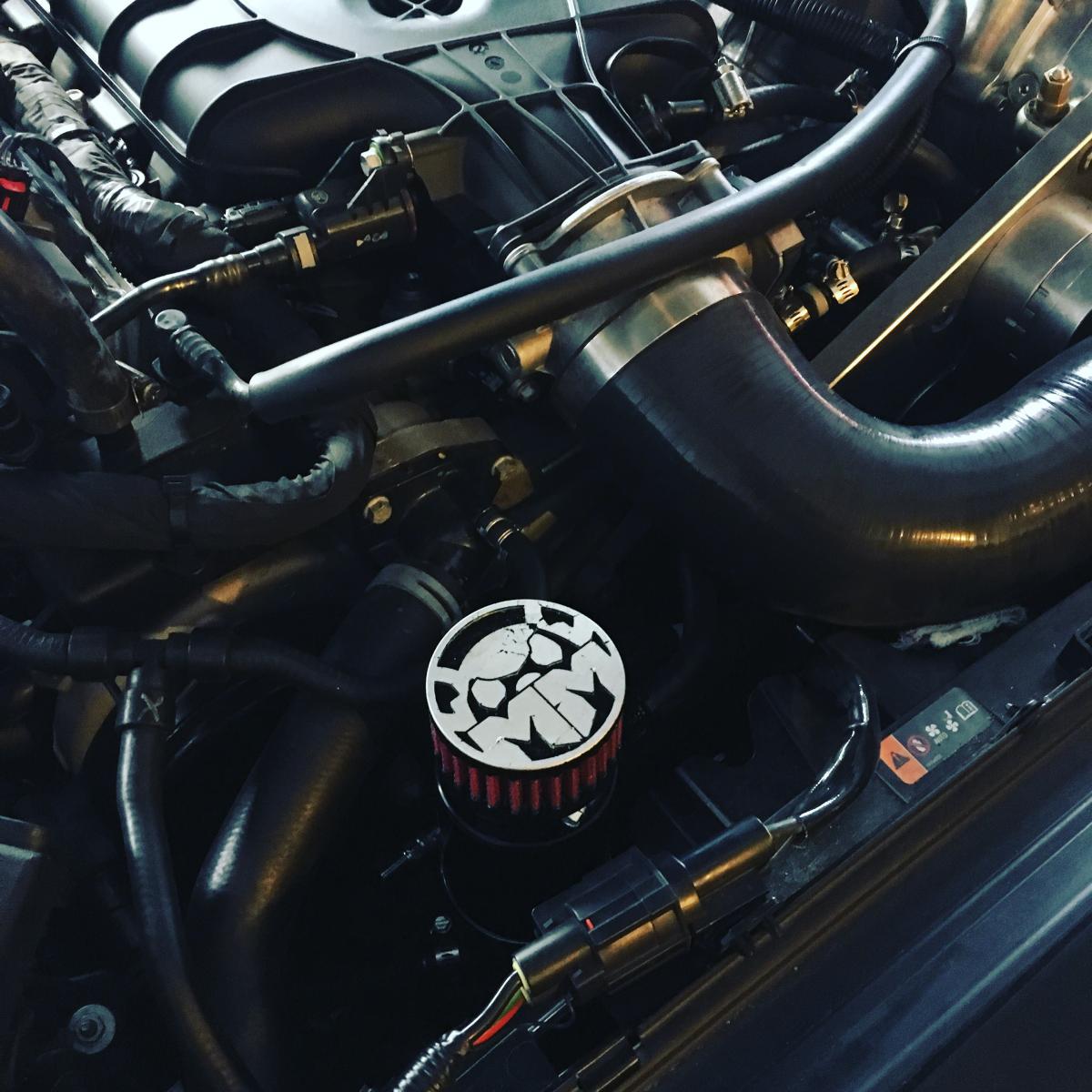

Originally Posted by oneredry View Post
on the same yet, slightly different subject. If someone makes a kit that has what mishimoto does to boosted engines, I'd buy one. since the ports have changed on the intake, I'm sorta lost as to how it would be routed. the the DIY kits seem decent in my opinion, I feel that there should be a vent/catch can type of set up.
Did you see the catch can I installed? Just needed one fitting and replace (reuse) an OEM fitting to get a better routing.
