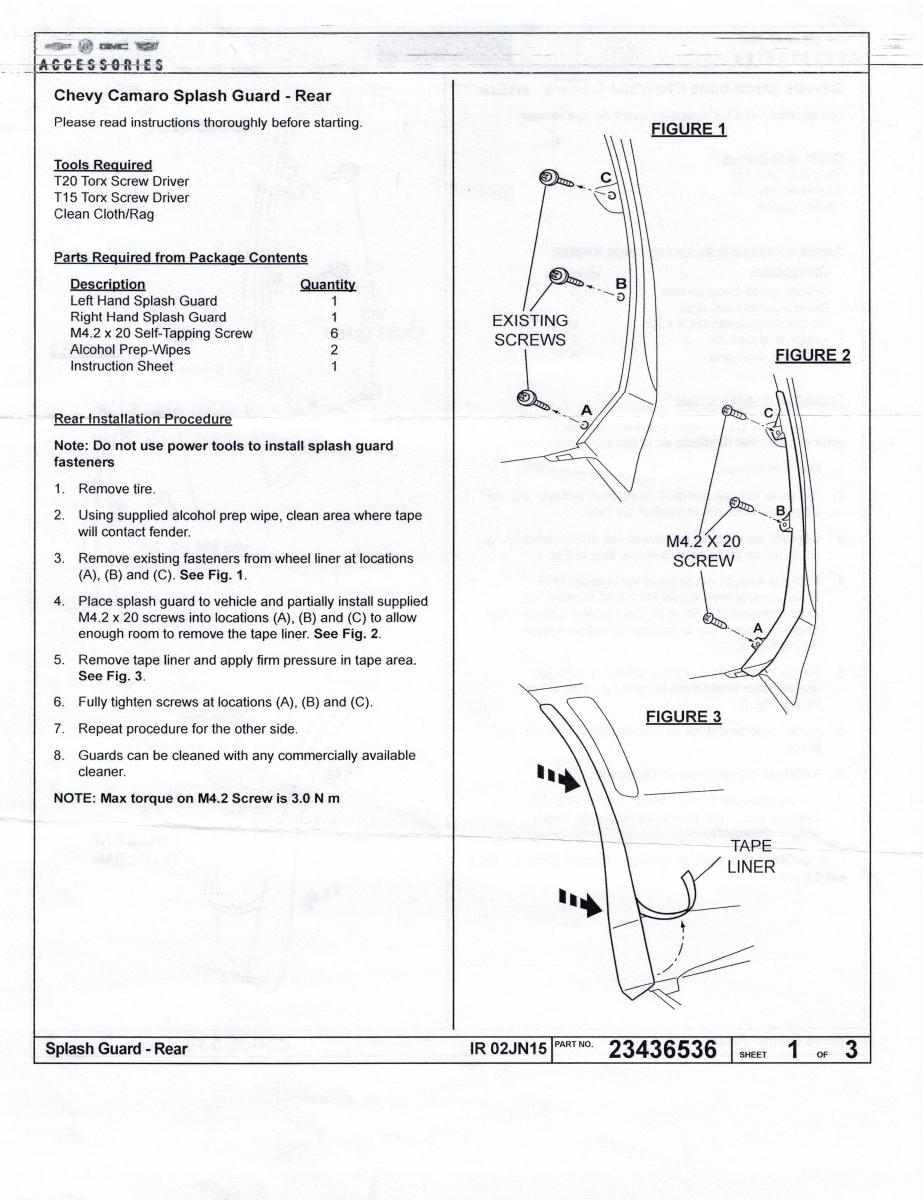

Originally Posted by SuperSound View Post
Anyone have a link to the install instructions for the splash guards? Just ordered mine today. I know I'll need a rivet gun.
I scanned what was in the boxes. I just got them yesterday and haven't installed them yet but it looks pretty easy if you're careful.

Awesome thanks!
