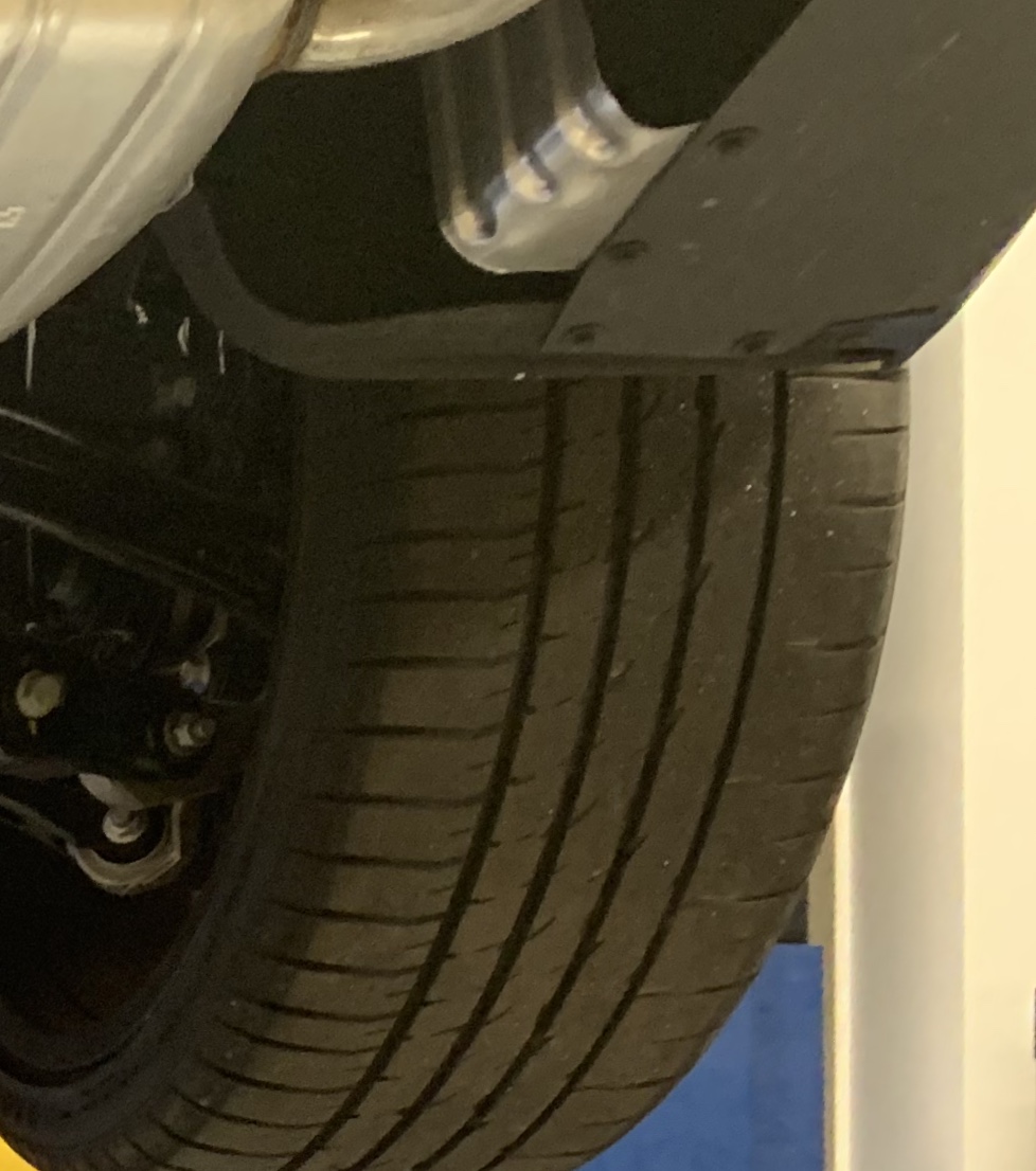

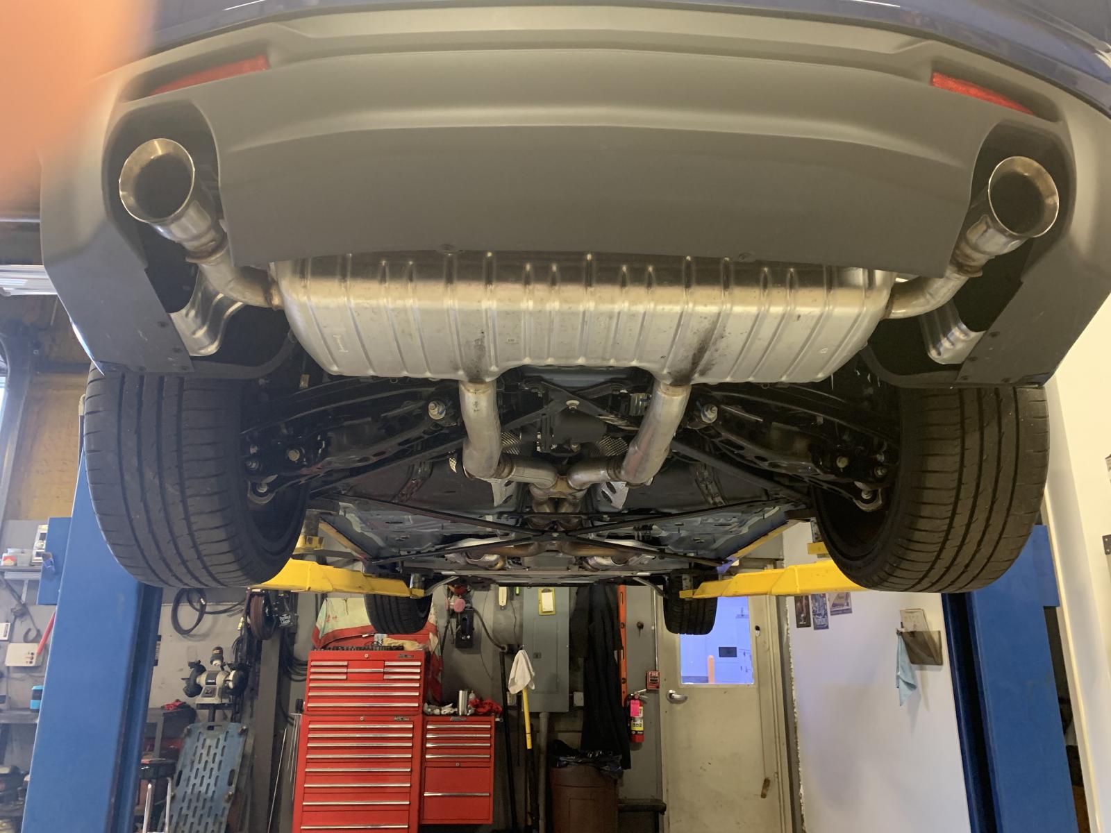

Old 08-18-2020, 07:17 PM   #40
Have2020want1969
Drives: 2020 SS
Join Date: Aug 2020
Location: Scarborough
Posts: 2
Rear Tire wear at 2100 miles
i have a 2020 SS and it has 2100 miles my wear tread is gone on the outside edge.The blue paint is still on the nut across the member so it hasnt been changed since factory. my back tires are spent. Going to dealership monday but they already tried to tell me warranty doesnt cover alignment. Any thoughts on this. im blown away. and it hasnt had enough burnouts!!! actually none on my watch! well maybe a peel out!

Old 08-21-2020, 03:25 PM   #41
Paro
Drives: 2016 Hyper Blue 2SS A8
Location: Boston
Posts: 37
Those pics show rear tires that are normal.
Paro is offline   Reply With Quote
Old 08-21-2020, 04:31 PM   #42
turbo2ltr
turbo2ltr's Avatar
Drives: 2018 1SS 1LE
Join Date: Jul 2020
Location: AZ
Posts: 161
That was my thought as well. What's the issue?
