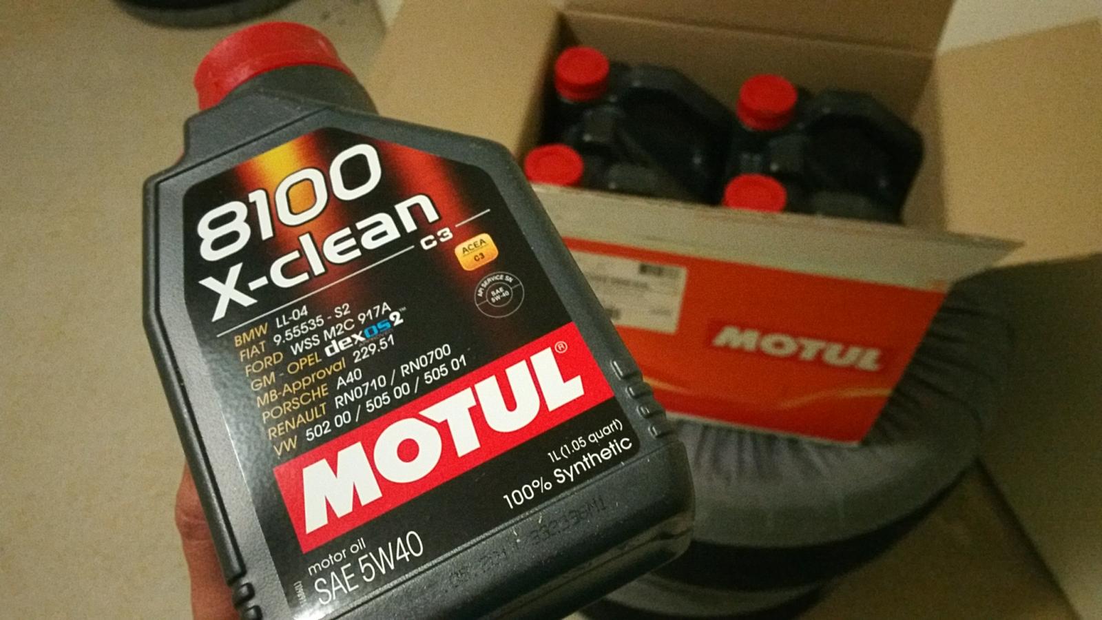

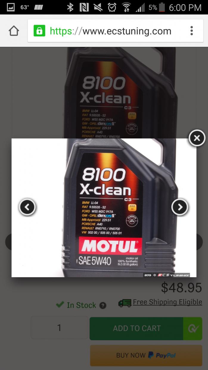

The only 5-40W Dexos 2 I can see is Amsoil European formula.
Old 05-07-2016, 12:24 AM   #38
evanescent03
evanescent03's Avatar
Drives: '19 SS 1LE/'19 Rubicon/'20 AT4
Join Date: May 2015
Location: USA
Posts: 505
This is what I'm going for. ... even has the #$&£?* dexos2 logo.
evanescent03 is offline   Reply With Quote

Join Date: May 2015
Location: USA
Posts: 505
sweet! This should work!

Posts: 5,012
Either oil is running $50 a jug. 2 jugs needed!! ouch$$$
Old 05-11-2016, 10:12 PM   #41
evanescent03
Join Date: May 2015
Location: USA
Posts: 505
Yeah. .. not inexpensive, that's for sure. Since it keeps us covered under warranty it's money well spent!
