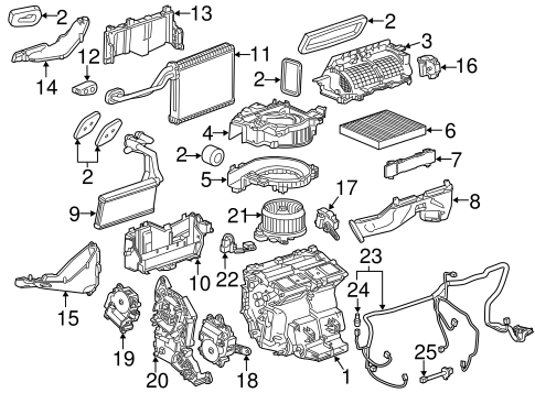

Good news is they have identified a root cause. Excessive or misapplied foam seal holding mode door open.
Bad news - It's inside number 1 in the diagram. 19 is the mode door actuator, door is inside A/C and heater case.
So if it's a foam issue, that may be why some cars do not have the issue...like I live in Florida, and use my a/c all the time, and have no real issues with this. Maybe my foam just happened to be installed correctly?
Yes. Some are fine and some are not.
Inconsistent quality control from the IP supplier.
