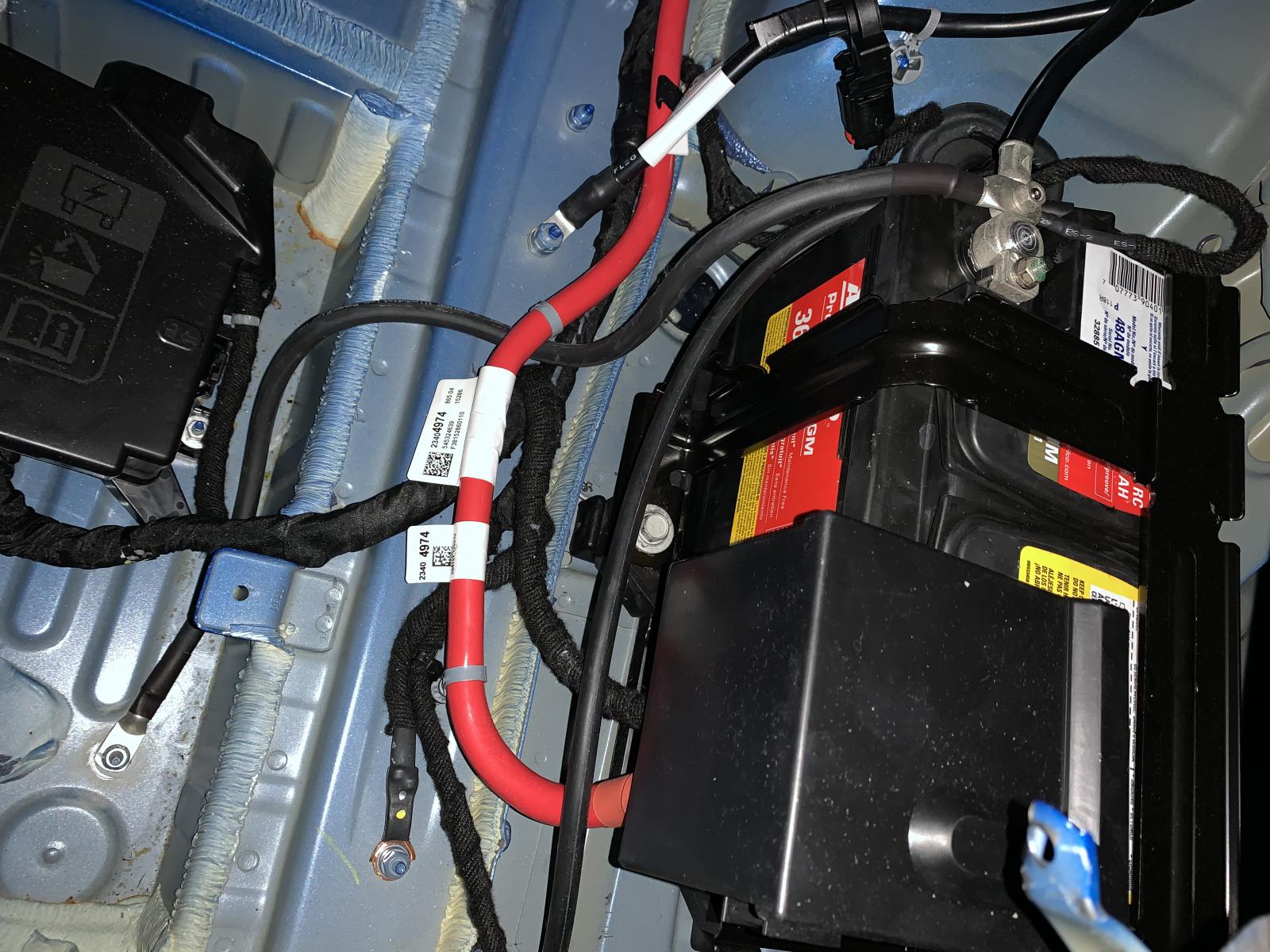

I have been dealing with this since I bought the car in 2016, but I still only have 22k miles on it. That said, I have put 7 batteries in my car.
I have purchased the ground cable and am awaiting it's arrival.
Question...When it won't start, are you saying that I could have connected my negative jumper cable between these two areas and the car should start? I'll have to give it a try while I wait for the cable to arrive. Anyone else know??
