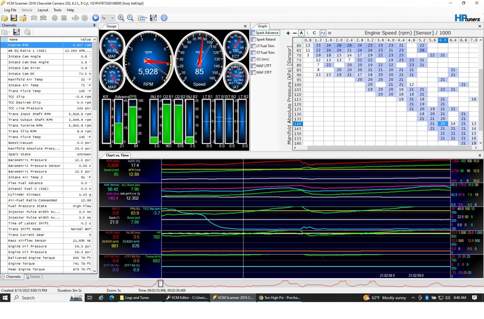

May have found some explanation about the TCC slip and settings in the tune. I dont have the tune open in front of me, so explaining from memory
Not sure why it was done this way, but the tune has the TCC regulator offset set at 80 psi. It appears that stock is around 20 psi...
I had been wondering why the TCC desired pressure caused slip at the stock setting of 114 psi, when others with a similar setup reported no slip. When I was on the 4.13 pulley, the pressure was increased by the tuner from 114 psi to 200 psi and slip went away.
Again, not sure why regulator offset was changed... but if the regulator offset does what i think it does then the 200 psi is really just 140 psi. In other words, the current 80 psi minus stock 20 psi means all the numbers are inflated by 60 psi in the tune. So 200 psi - 60 psi is 140 psi. And when the tune was originally provided, the value of 114 was really 54 psi.
The values in the apply ramp were also hugely inflated over stock too. Probably to account for the increased regulator offset. Ill try to remeber to post actual table data later.
Anyway... it just didnt add up to me leading me to believe that at 200 psi of pressure i was still getting TCC slip. Made me think it was a mechanical issue....
Who knows maybe it still is..... but after i compared some other tune info... it makes more sense that the TCC regulator offset is making those pressure values appear higher than they actually are. And if i can verify that, then i feel more confident in adding some addl pressure to the TCC desired pressure to try to get full lockup.
Would be nice to see an actual tune file where this is all working on a similar setup. If you are willing to share, PM me.

Mine is
(TCM) 35050 TCC Max Allowed Pressure = 250.0 psi accross the board.
my offset is also 80 psi.
regulator gain 0.360
TCC desired pressure max's out at 114 (which is the stock setting)
TCC Apply Pressure Ramp is also higher everything to the right of "0"
TC will completely lock up.

Originally Posted by grampa_ss View Post
Mine is
Thanks for sharing that. VERY helpful to see actual data.
I added 20 psi to the max desired pressure, gave things a good thrashing, and it looks like it had ZERO impact on slip. I'm not going to add any more pressure because honestly, even that was a shot in the dark and I may roll that back.
Good news is that I got the shift points under control and its peaking at a much more reasonable 11.5 psi. This is perfect and exactly where I want it given the 90 degree temps today.
From the MAF/CYL numbers, etc... there was no real difference between the accidental 13-14 psi numbers and these 11.5 psi numbers. There was a pretty big temp difference. When I got 13-14 psi, it was 73 degrees out and today its 90... The fact that there was no difference in measured airflow between 13.5 psi @ 73 degrees and 11.5 psi @ 90 degrees probably means the bottleneck is somewhere else, thinking on the cam/exhaust side of things. Which exhaust is something I'll consider, but no cam in the near future.
So I'm still equally split here on whether the tcc slip is real and the values in the log are just bogus. If it IS real then i'm leaning mechanical issue.
I guess next step is to post on HPT forum and see if anyone has any insight there. I'm not tearing out the tranny unless something is obviously going wrong there. I'll just change it to shift unlocked at wot before I do that
Super happy with this configuration except for the unknown TCC issues.
