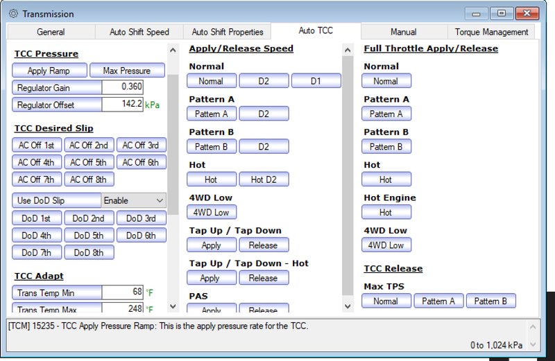

Originally Posted by EFI Tuning View Post
Here are some captures of the pertinent tables...
In the desired slip table you will see GM allows for a certain amount of slip in the low torque output ranges (ie. cruising, light acceleration). I have these zeroed out on my car for all of the gears.
The ramp rate table applies pressure based on how much current slip there is. The greater the slip amount the more pressure that is applied to bring it to the target slip value. I have this table raised 20% on my car.
Attachment 904989
Attachment 904990
Attachment 904991
Tim
Tim why dont I have access to these tables under the "Auto TCC" tab like you do? I just got HP Tuners about 3 weeks ago id like to alter these tables as you have suggested. Thank you for posting this information as well.

You need the latest beta version of the software. Email their tech support and they'll take care of you.
Sorry I missed your question but it looks like Darth took care of it.
Keep in mind if you have a 2017+ you will need to send your TCM to HP Tuners before you will be able to read and update it. 2016s don't require removing and sending in the TCM.
