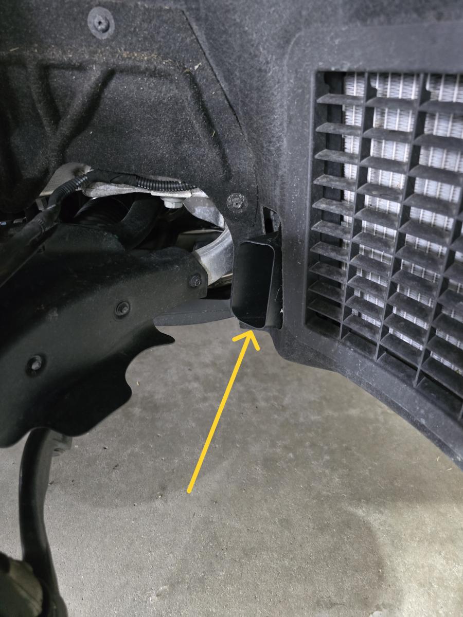

Quick follow up and a couple of questions.
Finally, had the chance to test fit the rims and as stated all looks good clearance wise.
Couple of questions though, is this the brake duct that several of you mentioned needing to be trimmed/removed (second pic)? I'd prefer to just remove it, does anyone know if that's a PITA job? Also, what are you guys using to clean up your Brembo calipers? After just a few hundred miles mine are looking pretty rough.

[JediVoice]That isn't the duct you're looking for.[/JediVoice] It's the plastic deflector (probably a better term) that's actually screwed to the lower control arm with three small (7mm or 8mm hex, I forget) screws, just to the left and roughly in line with the yellow arrow in your pic. The part of that deflector that juts out forward and already has a cutout for a wheel/tire is where your snow setup might touch at full steering lock. You can easily remove this deflector on each side: unscrew those three screws and you'll also need to remove the single plastic rivet fastener that holds the ABS wire to the top of the deflector.

Too funny, I'm rewatching Star Wars with my kids.
Good information and thanks again for the assist! Weathertech's are showing up tomorrow, so winter prep is moving along nicely.

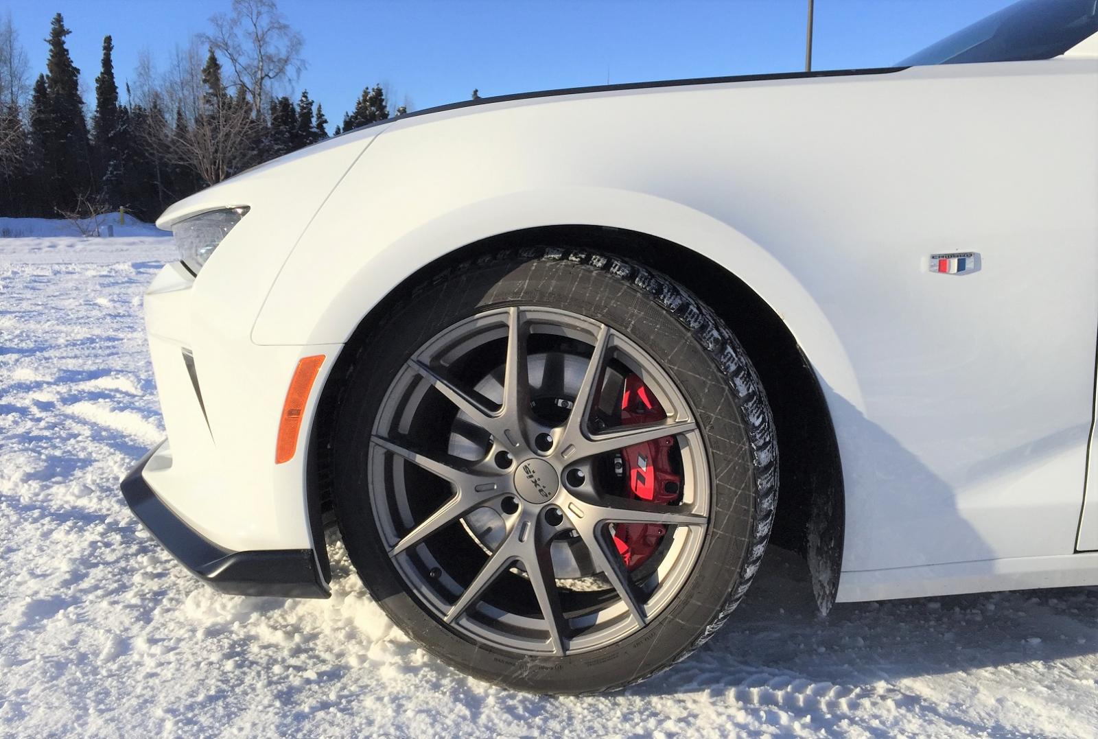

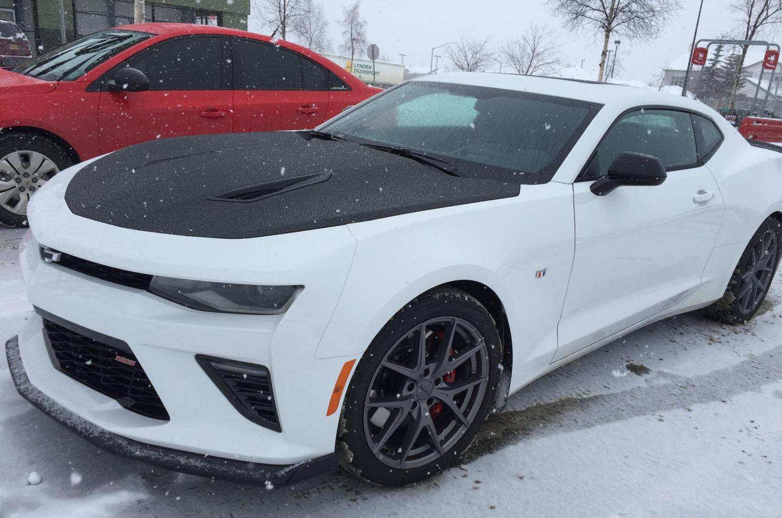

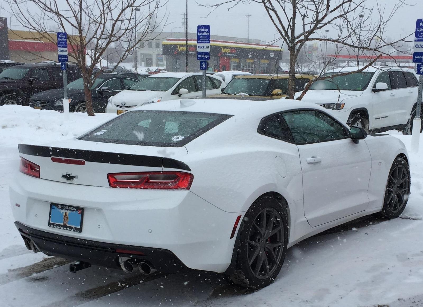

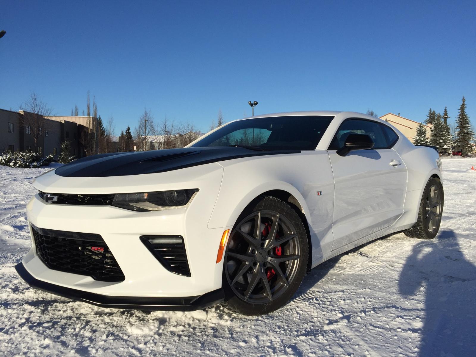

I got a nice square setup from Tirerack, run studded 255s. Works pretty well.
Axis 19X8.5 5-120 ET15 AXIS XR.
Runs great square, not "sucked in", able to rotate easy, at least decent width. After running 255 though it's comical that they put these on the rear end of cars (for summer).

Thanks for that, your car looks great!!!

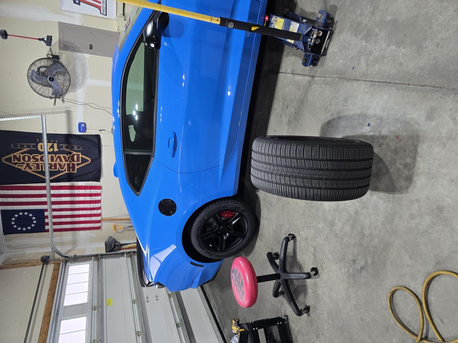

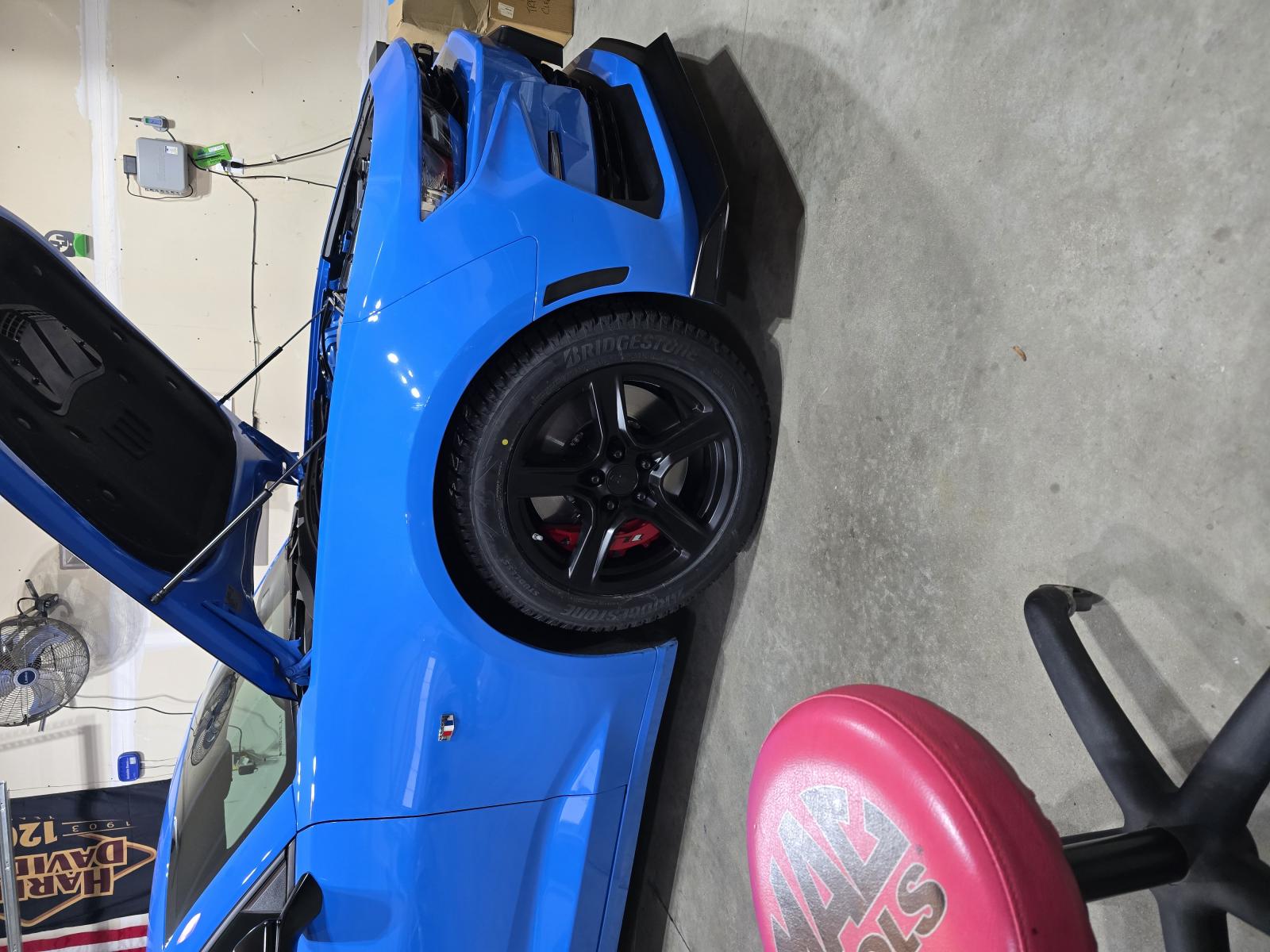

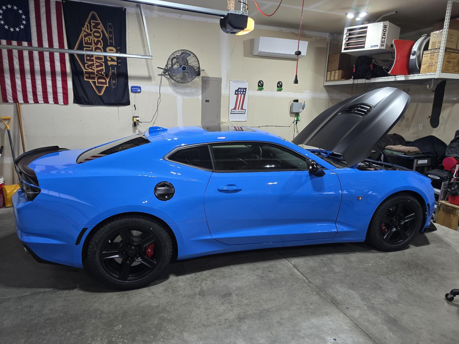

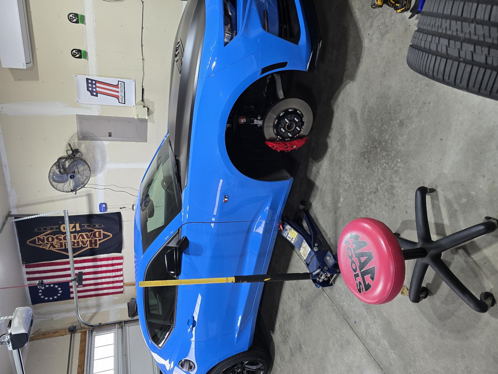

Alright, new shoes ready for winter, square 18x8.5 OEM rims and 245/50-18 Blizzaks. I think it looks pretty good. Thanks for all the help guys, from getting a setup that would fit to removing the air diverter, I couldn't have done it without you.
EDIT: ugh, why does the forum insist on rotating some pics???
