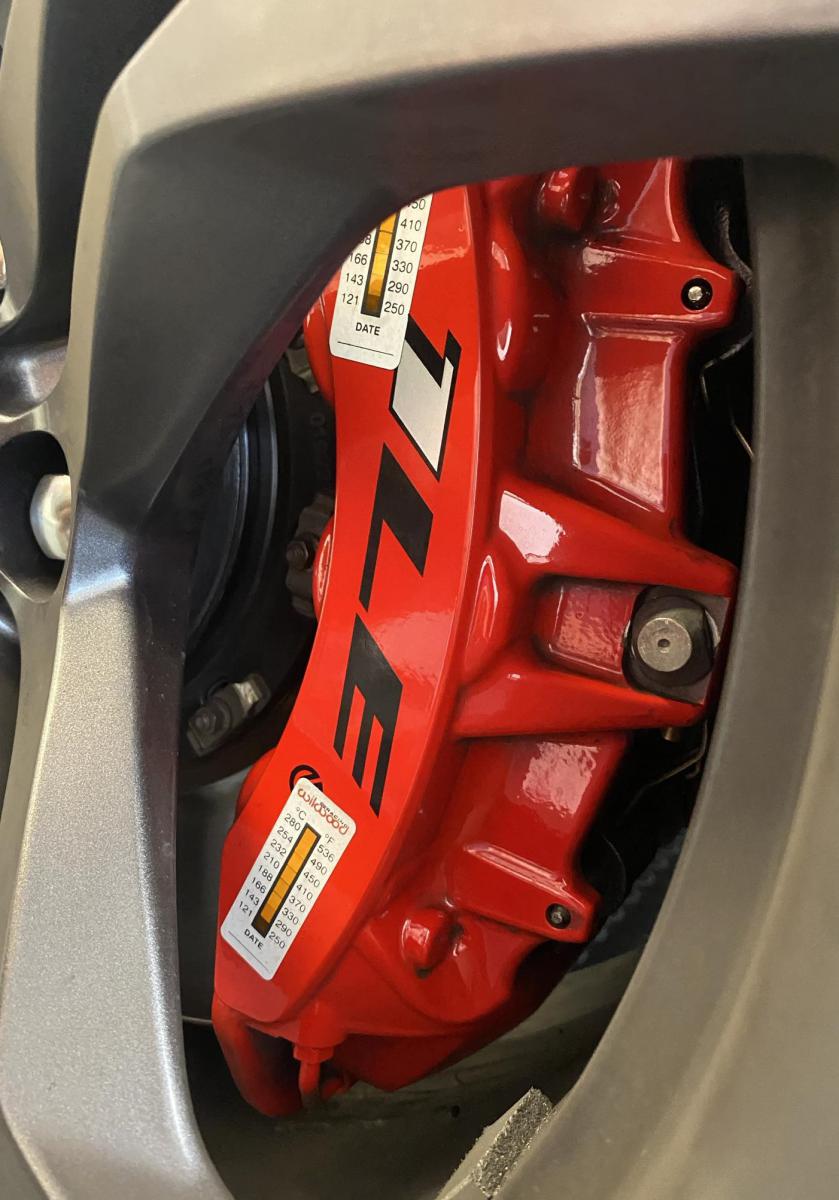

Those calipers are cooked. Brembo's powder coating will darken with excessive heat. Check your dust boots, they are probably fried and I would not have high confidence on the piston seals. Time for a rebuild. This discoloration was a little more common on the Gen5s, especially SS 1LE's that did not have any brake cooling. Ever wonder why the Gen5 ZL1 had black calipers form the factory? lol. That car had cooling but it was 580 HP and heavy!
Do yo have the brake deflectors installed on the radius rod (forward, angular control rod)? They came with the car, installed. Regular SS's had much larger flat ones in the trunk at delivery, and until recently those were the ticket to improve front brake cooling. But now the CT5 BlackWing front deflectors are the go-to for improving cooling.
But realistically you are using a much more aggressive pad and the car was not engineered to use that pad. But even at that, there's plenty of guys using those pads and don't have issues. At your skill level you shouldn't be overusing them. The mode selection can matter but usually it's the rear brakes that see the most use to settle the car. If you have good car control, Race mode will be a breeze. I typically run "all off" at my local track, Pitt Race.
Since your pedal returned, it was not fluid boiling. SRF has hot compressibility. I experienced it with my Gen5 SS 1LE. Once the fluid cools down enough the firm pedal returns. Brembo HTC64T and Endless are better for that trait. I wouldn't think you faded those Hawks.
I ran the Alcon caliper stickers on my 6 piston front Gen5 ZL1 equipped '14 SS 1LE. And I ran Raybestos ST43 race pads. Lots of heat. Even though I had lots of cooling, my calipers saw 450*F. I currently have a BCD (copper free package) equipped '22 SS 1LE. The most aggressive pad I've run is the Ferodo DS1.11. Since the BCD brakes are thermal overkill on an SS 1LE the most caliper temp I've seen is 250*F (below pic).
Attachment 1154030
Thanks for the detailed response. Saw your FB post also.
I get the questions about technique, as you don’t know me.
The strange thing about all this was that I didn’t change the way I used the brakes since last time at the same track, had the same fluid, and the same pads. The only difference was a bit more speed.
And the other strange thing is how the car was fine the rest of the day with nothing more than a mode change and perhaps some conscious awareness of brake preservation.
I might just buy new calipers and have these built and on the shelf as spares.

Was there much of a change in ambient temps from the last time you successfully ran the same combo?
Maybe the front caliper seals are getting lazy and the pads were not being pulled in enough? They were dragging? When, if ever, were they rebuilt last?

Not abnormal at all... it's quite common. A quick search will confirm that.
It depends on the track and pads used, higher mu pads make more heat in the caliper, and if you use up the brake pad there will be more heat transferred to the caliper as the pad wears.
With Ferodo 3.12 pads my calipers started to darken a bit after the pads were about half worn, and gradually darkened more as the pads were used up. Brakes work just fine, Brembo HTC64T fluid, carbon lines, CT5V deflectors.

Dave, I think caliper discoloration is common elsewhere but I'd venture to say uncommon when it comes to the Camaro.
Same track?
Same track, similar ambient, car only has 15k miles on it, so calipers are original.
Only thing that changed was the tune, and any inadvertent change in driving style by the idiot behind the wheel.
You’re not the first person to tell me this is not unusual and, perhaps, nothing to be terrible concerned about.
Spoke to another person who this happened to. He said the dust boots burned up, but otherwise fine. Another told me it is common for Sport 1 to burn up the brakes once you approach a certain speed/level.
