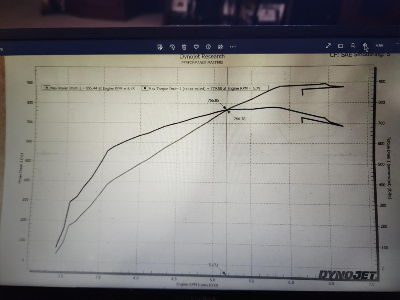

DA 2200 ft car went too rich here to 10.0 cause I never tried it at this power level and the maf was tuned rich that far up.
93 and meth with lt4 injectors and pump with STOCK intank and jms booster
Wonder what would happen if I let that d1x really eat.
Because its a procharger with 315 nitto 2s I can hook that in second gear on in warm weather. Just barley tho lol
Car has hundreds i do mean hundreds of pulls on 850 wheel with stock valve train no e85 who needs it? not me. Im not locked to any area that has e85 cause I dont need it to make killer power. I go on all kinds of trips with this car. and I can hit it at anytime.
P.S. If i drive it normal gets 26 mpg verses 18 or less when running run e 50 or 60.
